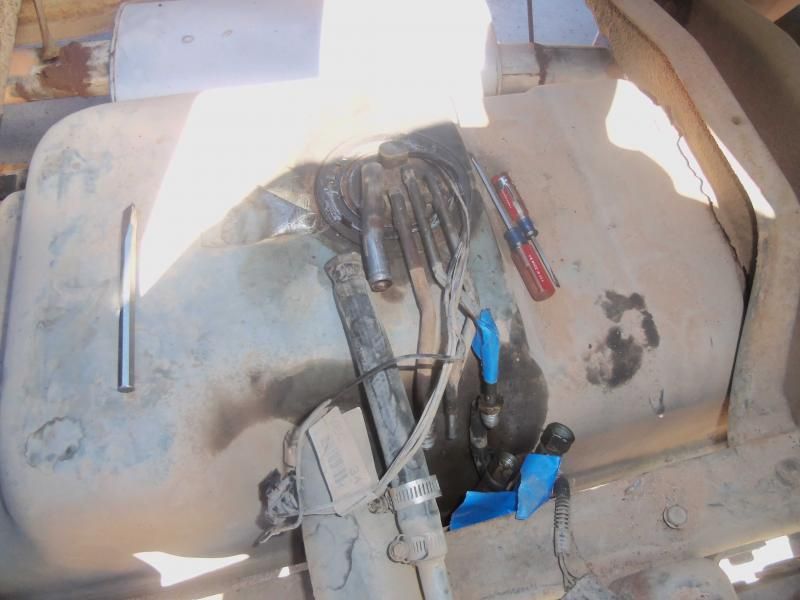

As expected, replacing the fuel filter didn't resolve anything, so today I finally replaced the fuel pump, which seems to have resolved the issue (truck wouldn't stay running long enough to turn it around this morning), but I won't be certain until I have a couple days/weeks without the symptoms.
Old fuel pump had 3-4 ohms of resistance at the terminals. New one had 11 ohms, so I suspect the old pump may have had some shorted windings in the electric motor.
I used an engine hoist to lift the bed off after removing the 8 bolts holding the bed on and disconnecting the tail lights near the drivers side rear corner, and a couple of ground wires (also on the driver side). It really made accessing the fuel line connections a cinch.

the fuel pump will fail because of many related component breakdowns. with a vehicle this old the relay need be replaced. the ground connections all checked and cleaned, connectors also checked for any corrosion . the fuel filter replacing need be done 30-40,000 miles. but that may need to be adjusted with the fuel quality in your area. more dust/dirt this may need be done more often.
the fuel pump is a DC motor and with a lower voltage due to poor feed/ground connections this is a common failure especially with very old vehicles. low fuel levels will also cause the motor to overheat causing the windings to short out.

Thanks for the info. Also, here's a couple pics I snapped to show the bed-off method of doing it:
Engine hoist holding the bed. If I did it again, I'd DEFINITELY put another strap on the bed, to avoid catastrophe if one were to break. I kinda put all my eggs in one basket on this lift - thankfully it all turned out. To straddle the middle of the bed with the hoist required me to remove the wheel on that side.
Here we see the fuel line connections that need to be disconnected:
Pulling the bed isn't too terribly miserable, but even with the hoist, it was crucial o have a spotter when removing the bed. If left entirely to manpower, I don't think I'd have been comfortable with any less than 5 persons helping (2 on each side to do the lifting, and one spotter to ensure no hangups. I have a spray-in bedliner, so that probably adds a substantial amount of weight to the bed.
I actually started to drop the fuel tank initially, but could only see the metal portion of the fuel lines that I needed to disconnect. Back at the fuel filter the lines are metal as well, so I was concerned with flexing them excessively while dropping the tank. After getting the bed off, I saw that there is actually an intermediate rubber section to the fuel lines, so partially dropping the tank in order to disconnect the lines would be possible. Still, I'd pull the bed again if I had to do it over - it's just so much easier to access everything that way. I also used a wire wheel to cleanup all the ground connections on the bed during re-installation.

on my 2000 silverado I slid the bed back about 18 inches or so then lifted up behind the cab the bed . tilting it so I had plenty of room to get at the fuel pump assy and the brake lines.
with this which many do on this style remove the rear bumper disconnect the fuel filler neck and ground wire/rear diff vent hose. the unbolt the 8 bolts holding the bed. place 2 x4 or 4x4 short pieces between the bed and the frame then slide back then tilt up. with the bed slid back the overhang weight allows ONE person to lift up the bed behind the cab.
if your vehicle were out here in the rust belt what you did would be impossible with most of this age. the bed would be so rusted out and the bolts would need a cutting.
the gm vehicles are fabricated better than fords to remove the bed.
washing off all the debris before working it is also what I did to prevent any issues. the lines can be pinched broken if the tank drop is used. the tank strap out here would also require replacing .. trucks looks good for a 1990.
I popped the bed off my '88 all by myself. Didn't think a thing of it. Even left some of the cargo in place. Lifted it up high enough to clear the tires, rolled the hoist-and-box out of the garage while I worked on the gas tank. When the tank was done, Me, myself, and I pushed the hoist/box back into position, and aligned the bolt holes using tapered alignment prybars.
'Course, it is the "lightweight" version of the long-bed, with the extra-cost weight-saving perforations.
Two things: Note that the chain is bolted around the lifting hook, to prevent the chain from sliding side-to-side; and the custom-cut 2X4 to prevent the bed sides from distorting inward.
The bolts holding the bed were the reason I bought a new impact gun. My old Snap-On IM510B struggled and hammered to get them loose. AFTER buying a new MG725, I pulled the screen out of my old gun--it's under the air inlet fitting--and found that it was 1/3 plugged with crap. Cleaned the screen and restored it's power to it's former glory.
Bolts were reinstalled with a coating of anti-seize!

Nice! If I'd been able to approach it from behind, it may have been a bit easier as well. Unfortunately, my minivan that is undergoing a transmission replacement was in front of it, so no room left on the concrete Also, your hoist appears to have just a bit more reach than mine to boot. For me to reach the midpoint of the bed put the ram cylinder nearly up against the bed. You're right though. If I'd done my homework and done a better job lifting at the CG, I probably could've done without the spotter.
