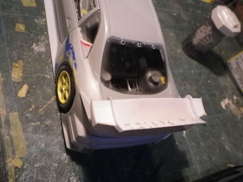

Rear of the bodyshell was rebuilt to replicate the high-downforce version.
Air outlet and vents on engine hood.
Rear Wing was scratchbuild from styrene sheet.

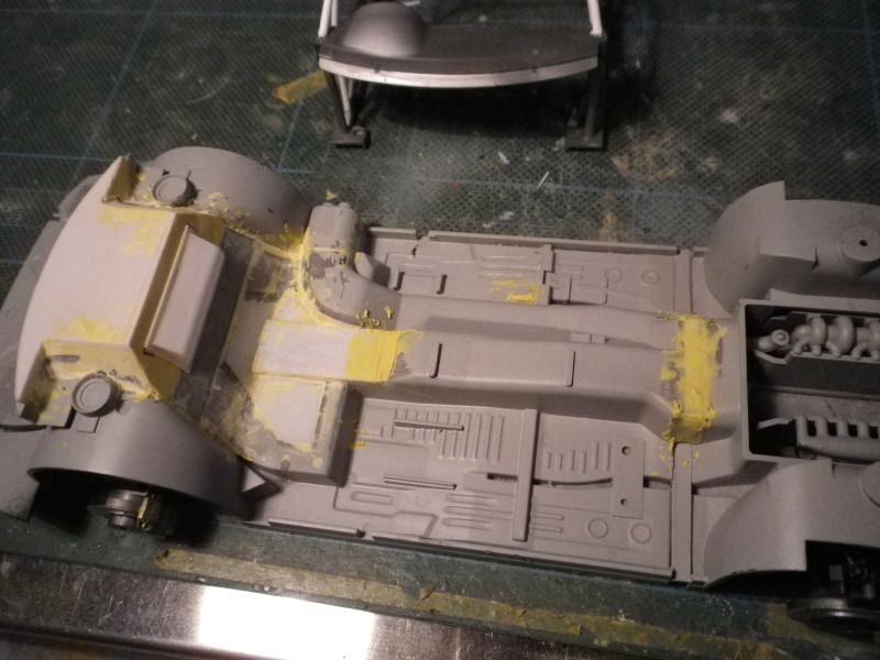

Chassis came from Tamiya R34 1999 JGTC. According to specification, wheelbase of R33 is longer than R34, so I extended the chassis by 3mm such that the wheels can be fit into the wheel arches.

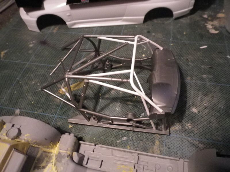

I modified the roll cage from R34 JGTC kit.
Chassis with roll cage.

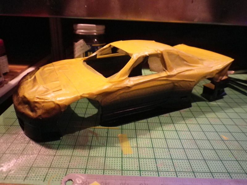

Body was masked for two tone color.

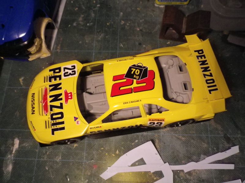

After spray work was done, it's time for applying decal. This time, I used Tabu decal which is designed for R33.

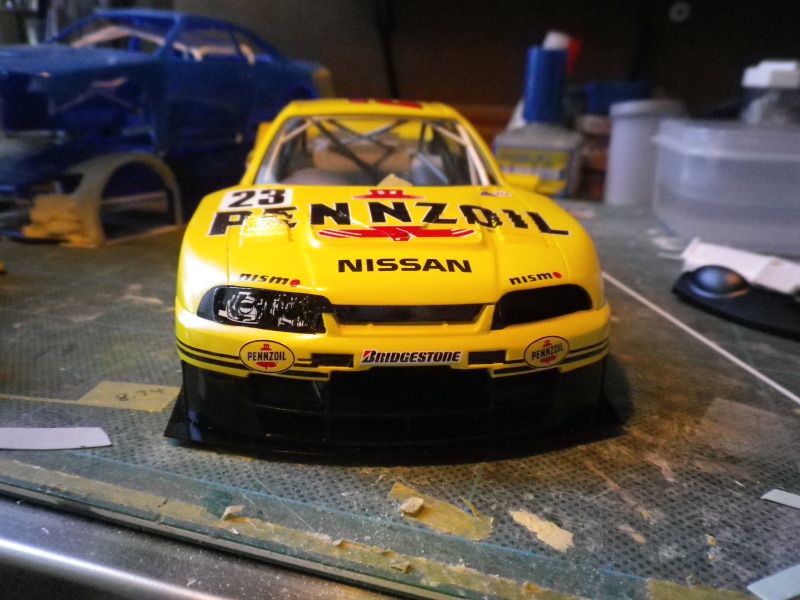

Honestly, the quality of the decal is excellent. All size of logo is fit with the body except the "Bridgestone" at front bumper and "Pennzoil" at engine hood.
I replaced the B by Original decal from Tamiya. For the "Pennzoil", I checked that the width of the entire logo is less than the actual car. So I cut it into separate parts and fixed them into position.
Decal work was completed.
