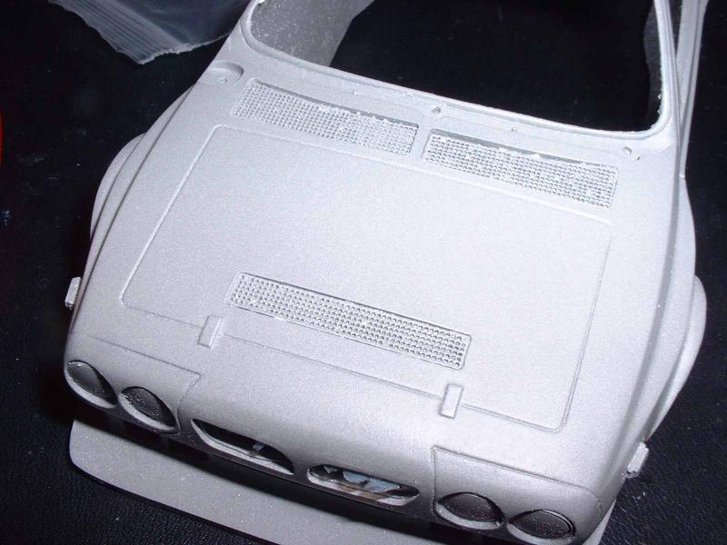

and this was the rims/wheel situation at today.
The only ones in my hands were the ugly ones from modellers...and the donor 037 ones.
It would be possible to use anyway also the 037 wheels if u apply on theme the 4 blacks air vents, covering the entire wheel.Probably that was teh reason why modellers rims were not so accurate
and these are the correct rims, aven if thos resin color doesnt give the idea
the final look of the correct wheels is this.I used the pirelli writings from my decal sheet
to make some other livery for 037 the 2 rims (1 rear and 1 front in pic) are this :
