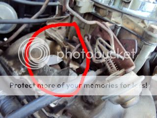

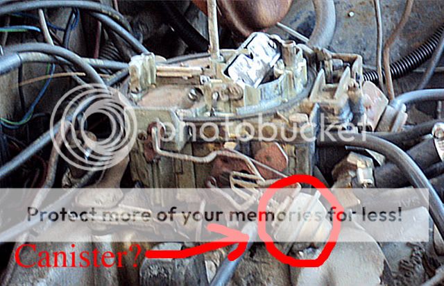

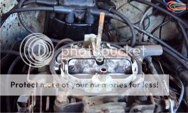

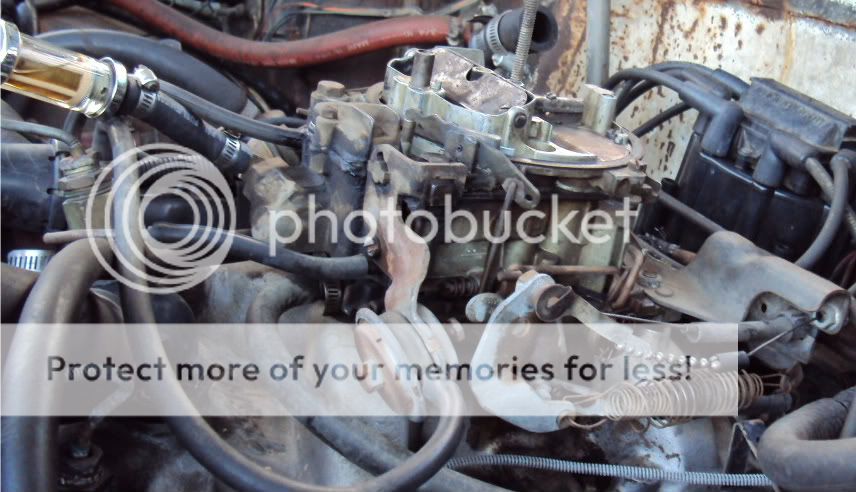

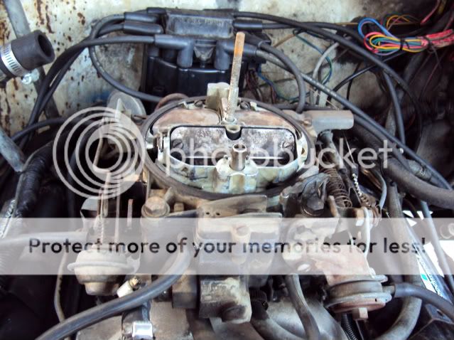

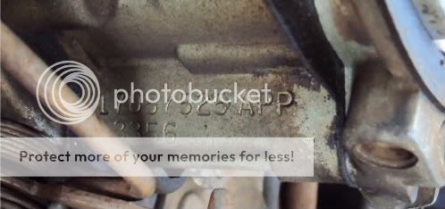

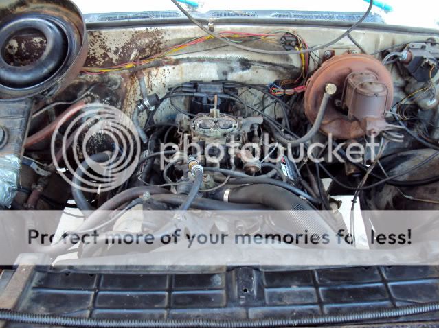

Some pictures of what Im working on.
Engine Bay:
Carb - Front View:
Carb - Top View:
Carb - Driver Side View:
Carb - Passenger Side View:

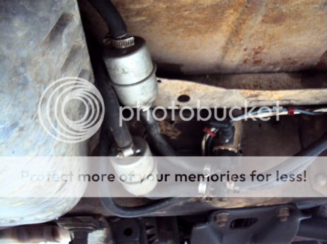

Fuel Filters to be Replaced:

- Test the canister on the carburetor to see if it the choke is working.

Right after the video, I swapped the two fuel filters in the back for two new ones. One of them had reddish gunk flow out, which you can see in the pictures below.

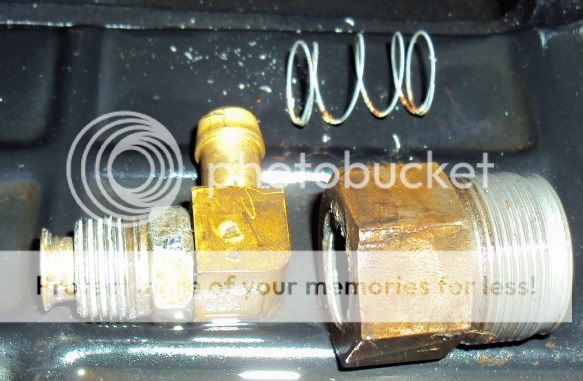

I did spray the carb with carb cleaner and finally opened up the carb's inlet to remove the filter but there wasn't one inside. There was a somewhat gunked-up spring inside that is in the picture below.
Shortly after this picture, the spring was lost in the depths of the engine bay and I realized I better wait until tomorrow before continuing anything.
After putting the inlet back on the carb, minus the spring, I primed the carb and fired it up. It start powerfully (at least when compared to recent starts) but died within 30 seconds.

Dropped in the battery after charging it all day. Found out that the glass-cased fuel filter right before the carb was facing the wrong way so I switched it to the correct position. I also discovered that a vacuum hose from the carb was removed when previously working on the fuel hose so I put that back on.
Then, going by the suggestion of a member on another forum, I floored the gas pedal and started her up. Below is a video link of what happened. Its all sound because it was too dark for the camera.

the fuel filter was installed wrong. so you reverse the filter so it is correct.... BAD !!!!!
NOW all the shit caught in the filter will flow to the carb...

GO DOWN AND BUY SEVERAL FUEL FILTERS...INSTALL CORRECTLY.
the fuel tank I would remove as much fuel as possible ..if it has a very yellow look to it , this is the alcohol fuel breaking down ..this is what is very bad on the metal as it corrodes every thing////
The old fuel can be burned ...call the gas stations in your area . they may have a heater system that uses waste oil/fuel to produce heat for the repair shop...I just dumped 7 gallons of gas that was in my boat tank yesterday..
another thing you can do ..after you clean the carb...get a small fuel tank like snow blower etc..hook up to the fuel pump see if you can get it to run good...
using a fuel syphon hook up to this fuel line entering the fuel pump and suck the gas out..have the front end down rear up///..
j cAT is offline   Reply With Quote
the carb cleaning requires the removal of the top portion .. this will then expose the float and seat. , bowl....all this needs cleaning with a sucking device and cloth ..NO PAPER....
I know. I messed up. But, the two metal inline filters before this one were just replaced and this one has stayed clean ever since it was cleaned out in the beginning.
I was told the carburetor will need cleaning and the float valve readjusted. I will get a kit for it as soon as possible.
In the mean time, I am thinking of swapping over a Holley (hopefully it fits with no issues, both carburetors are spread bore I believe). That way, I can patiently work on the carburetor while still being able to move the truck around.
I removed as much fuel as possible by siphoning it and took out a total of 6 gallons. I can hear fuel in the gas tank but for some reason the hose won’t pick it up. The fuel gauge does show as being 1/8th of a tank full. And yes, the fuel does have a very yellow color to it.
Yikes, 7 gallons!?! I’ll ask the local gas stations but I have never seen such heaters out here. Or I'll put on an add on Craigslist. No matter, it will be disposed of properly. Might take a few BBQs.
I'll try it with the lawn ower.
Excellent idea. The truck is on an incline driveway facing downhill. I can lift it some more if needed.
j cAT, as always, you rock!

I should probably stay out of this, but what the heck.
After 30 minutes of trying to read thru all your info I just went back to the 1st.
I feel that all your issues are related to the Q-Jet choke system (and possibly internal stuff).
1st off is the "canister" you have circled. It's called the "choke pull-off". Once the motor starts with full choke it opens the choke to a set position from engine vacuum. If this unit is not holding vacuum the choke will not open to the set position!!
2nd is this is not a manual choke. It relies on a heat sensitive spring that is mounted on the intake below the carb on the passenger side. If this spring is broken the choke will not set properly to the fully closed position!!
3rd is that I saw somewhere in all this a mention of checking the dist points?? '77 dist's are HEI and don't have points.
RE points 1 & 2: All adjustments on the choke system have to be made manually by bending the rods that attach to each of the choke components.
Lastly, older Q-Jets are known for worn throttle plate shafts (major vacuum leak) and leaking main jet bowls (flooding).

I greatly welcome and very much appreciate all help.
Since I have never dealt with carb’d vehicles before, I am trying my best to describe everything as best as possible. I am 100% carburetor illiterate but I am also hoping to change that with this project. I hope I wasn’t confusing or too wordy because I wrote everything with the intention that someone in a similar situation and lack of knowledge may find this useful someday.
Yes, someone pointed that out on another forum. From the first video (it’s the daylight one), it can be seen engaging at once when the truck started at what I assume is the proper speed. I actually refered to it as a canister for the other forum since they responded first and i am linking the same images to both.
You are correct again Sir. Someone pointed out that it is the older choke stove style.

Your Q-Jet is not electric choke. It has the "divorced" choke. The number is usually stamped on the drivers side towards the front.
This lever, I assume, is what controls it.
Found the number this morning:17057525 APP 3356

The Q-Jet has only one float and it does not come in the kit. Not real sure if you can get a brass one.
Yes the circled item is the rod that goes to the spring on the manifold heat sink.
Since you're a self proclaimed rookie on carb's the Q-Jet is probably one of the worst for a 1st timer. That's just my opinion and I've been doing them for over 40 years.
An electric choke is ok, but the setup that's on there now is much better when it's been dialed in.
Good luck to you.
