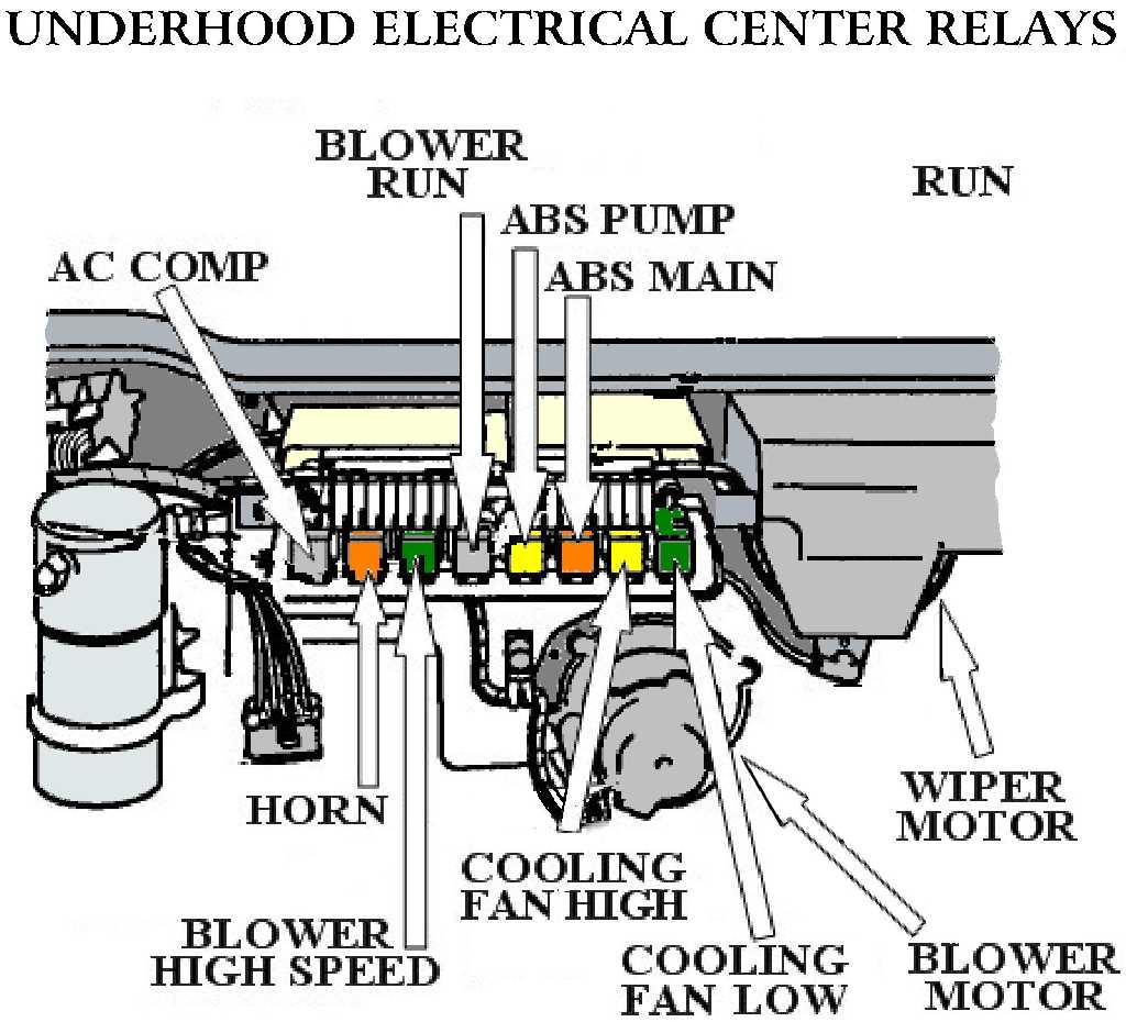

Instead of jumpering the non-existent switch you can jumper the compressor relay instead. This is from a '95 and '97 should be similar:
You should also check the 15A fuse (6E) in the IP fuse panel.

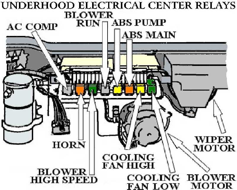

Geoff or Jeff, (Blue Bowtie) can you change the pixel size on that pic to 800 X 640? It's way to big @ 1024 X 930. Thanks!

O.K. - But just for you:
