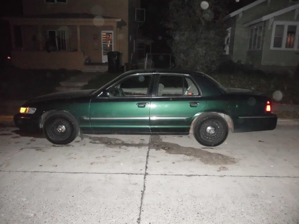

A little bit of a wheel change. she was kinda dirty in this picture, i will get some good ones today.
