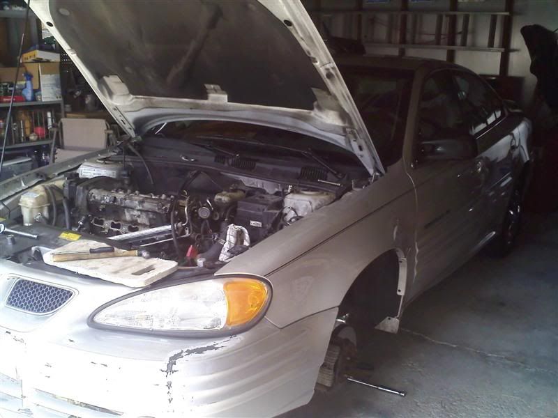

As you probably know I picked up a 2001 Grand Am 4cly as a DD and winter car. I got it for real cheap from a buddy because it doesn't run. He said a blown head gasket, but wasn't 100% sure. Also, pretty much every dash light is on.
The goal is to spend as little as possible on this car to get back and running, and be my DD while the Talon becomes a beast. The tires and battery are brand new, which costs more than what I paid for the car. He wanted it gone, so we had a great deal of $250.
This was the car when I got it towed by his brother to my street.

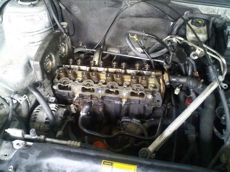

Today I got her to my parents house and diagnosed the problems. Crazy amount of coolant was mixed with the oil... blown head gasket. So I started tearing her down.
And the motor.
This all this with no books and just the help of my bro. I got pretty much everything off of this thing, minus the timing chain. I need to rent a pulley puller and get that all squared away, then the head will pop right off. Going to order all my stuff tonight and see how to all turns out.

Worked on it today. Ran into some problems, so this is as far as I got so far. 2 more bolts (that I can't get to right now) and the head is off. Working more tomorrow.

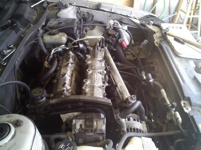

That was the motor about noon yesterday. I had to drain the cylinders since they were filled with fuel from trying to start and left over coolant and oil and then relubed everything.
Right now the car has the head on, cams most of the way in, and a lot is back together. I was trying to do the timing chain but was having problems, and called it quits when I ran my finger between a cam gear and the chain when I left go of the tension. Ouch.
Got a new O2 sensor in there. Head and block are flat.
Tonight I'm headed back to my parents with my buddy and we're going to finish it up. Startup was supposed to be yesterday, but I'm pretty conifdent it will happen tonight.
