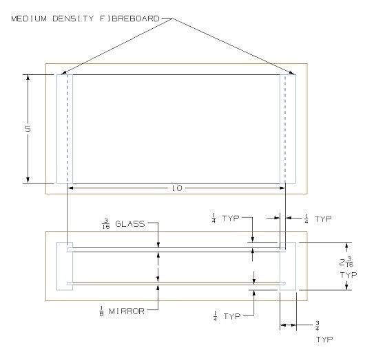

Any "how tos" out there on making a display base?
This is specifically for competitions. I looked around and searched quite a bit and couldn't find much. A few things, but not what I was looking for. I'd like to make my own rather than buying a pre-fab piece. I like SMS's stands and was curious if anyone make anytihng like that for themself (with the angled mirror to show off the underside of the car. Just curious. Thanks.

Re: Any "how tos" out there on making a display base?
Racer93

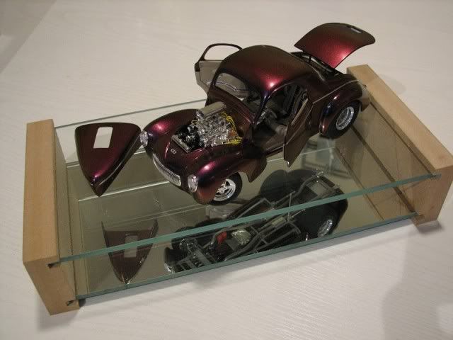

Here is a pic of a display base that came from some other fourm that I saved. Let me know if this is maybe what you are looking for? If it is
I will post the plans for it tomarrow.

Jimmy,
That is EXACTLY what I was looking for! If you could post your plans (ie/ dimensions), I'd appreciate it! Thanks!

Here you go racer,
