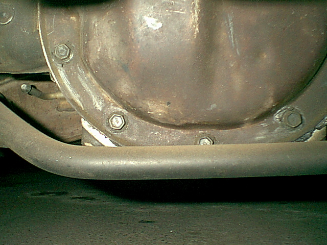

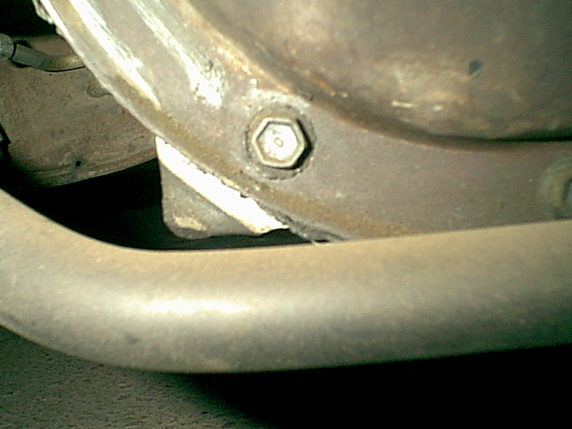

Some of them have a code, some do not. If you see a "G87" in the trunk, it's an 8.5", but if you don't see that, it doesn't mean it isn't. G89 is definitive proof of a 7.5". The rear cover on the 8.5" seems to stick out a good distance and the pan itself is oval shaped, while the 7.5" has a less protrusive cover and is more of a rounded square shape. The easy way to tell the two apart is by looking at the bottom of the differential casting - a 7.5" will have, on the bottom, on either side of middle, a machine pad with a 'hook' shape while the 8.5" will have square shapes sticking out below the cover.
This is an 8.5" (it's the diff on my car):
closeup of the square machine pad:
