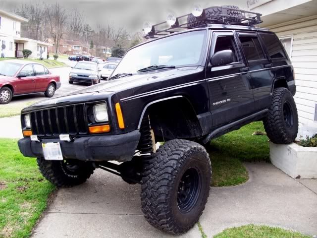

Here's mine, and what I run... The "Urban Crawler"
*'98 Cherokee Limited * 4.0L HO 6 cyl With Automatic Trans and 242 Transfer Case * Rusty's 4.5" Front and Rear, 1.5" Shackles Rear * Clayton Long Arms Setup * Custom Upper Rear Shock Mount Crossmember * Heavy Duty Track Bar and Frame Mount * JKS Quicker Discos * Front Stainless Braided Brake Lines * Dana 30 Front Axle With 4.10 gears and ARB Air Locker * Ford 8.8 Rear Axle With 4.10 gears, Disc Brakes and ARB Air Locker * ARB Onboard Air Compressor * Transfer Case and Gas Tank Skid Plates * Rear 2" Receiver Hitch * Front Tow Hooks * Surco Safari Rack With 4 Hella 500's (3 Front and 1 Rear) * Two 55 Watt Backup Lights Mounted Inside Rear Bumper * Custom 4x4 Fabrication Double Tube Rock Rails * Lower Section of Doors, Fenders and Rear Body Panel, Bumpers and Fender Flares Herculined * Cheapo Cobra CB Radio * Huskyliner Dish Style Floormats * SYE & CV Driveshaft Conversion * 33x12.50 BF Goodrich Radial Mud Terrain KM's on AR 767s w/Full Spare * 700 Watt Power Inverter Mounted Under Passenger Seat * Boston Acoustics Front Speakers, Infinity Kappa Rear Speakers *K&N Cone Filter *Pace Setter Headers (PITA!) *62mm Bored Throttle Body *1" 62mm Bored Throttle Body Spacer * Etc...
I found this rig locally just after Thanksgiving '06. The previous owner was asking $7800. He settled at $5800.. Since then, I put on the 33x12.50" tires (4+ a full spare), [with fender trimming], and the bored TB and TB spacers for around $1250 total. On top of what I paid for the rest that was already done for her... !
My point is that there is really no reason that I can fathom to torture one's self to an extremely unecessary height.(UNLE$$, TO PRODUCE A $HOW TRUCK) The JEEP was, and is made to function. On and Off-Road, at stock or moderately, (by GRAVEDIGGER standards), lifted heights!(3-6.5"!) I have never seen nor heard of the 'Amazing Hummer2',(who makes those things BTW?), out-wheeling any model of JEEP at the same height, given the same calibur of driver. JMHO...
~Good Luck!

Wow...that is a beautiful buy...
I think some of those lift numbers on his post (BTTT) include the tire height..
I said that is not the way we talk about it...
Suspension height is the spring height...not the body height..
EDIT: especially having the ARB lockers with the onboard air.....awesome.

Man let me tell you, I'M IN LOVE MAN!!! Every d*mn day I even look out the bloody window, I striaght stare at her for a good long while. . . Then I think to myself, 'Wow, dude... you really own that thing. What do ya wanna do to her next?' I just can't believe it. Really. It just won't sink in! I love it!
I sent you a pm a while back just before I bought it to get some advice about some/all of the mods to ultimately try and figure out if it was worth the 78 he was asking. I dunno what happened, but let me tell ya, I sure as h*ll went to 'look at it' with ca$h in tow!- Right after I spent the night before trying to add all of it up. I quit researching when I hit the $10,000 mark. (4k for the rig itself) And all of that was w/o any labor added in!!
The OBA is pretty cool, although slow as can be for re-airing. But it does get the job done. The lockers themselves are fantastic! They work flawlessly and seem bombproof enough to me...
