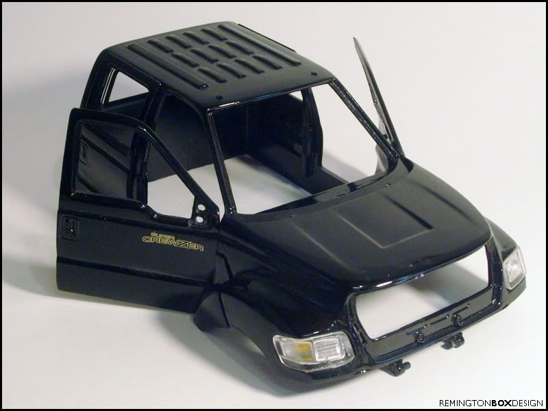

I have a diecast body that I want to build a few different ways. Is there anyone that can cast me 5-10 copies of the bodies?

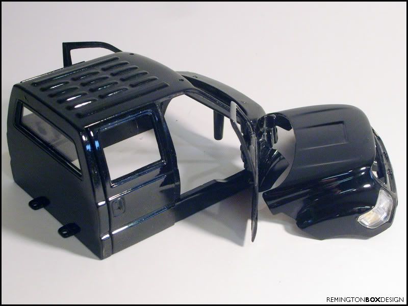

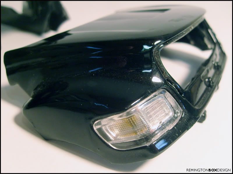

A Ford F-650, 1:24, 4 parts
As you can see the front clip is separate. Also, the doors will come off and hopefully get cast separately.
