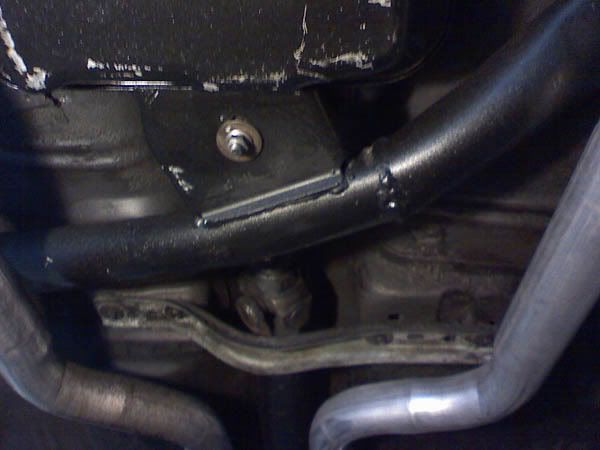

Also if you're running duals I'd recommend doing some work to the crossmember. I had the exhaust shop weld together (extra $100 on top of exhaust charges) both right sides of a 700r4 crossmember and a 200r4 crossmember (I've got a 700r4). You can see the weld in this pic. That makes for dual humps for a cleaner pipe install.

thanks for all the input. I think i'm gonna go with the 50 series on mine. (it is a three chamber) when i had my ram i put a dual exhaust bolt on from gibson. that kit had 1 muffler and then two exiting pipes. for my caprice, i would have to change the catalytic converter set up, correct? will this keep the car from passing inspection in NY? they don't do emission on 25+ year cars from what i can see so maybe it won't matter.
the benefits of a true dual exhaust relate to strictly power/performance gains or will the overall engine life/care be better as well? I have no intentions of trying to push more power from my car. I just love the model design period. With that being said, I want to get the dual exhaust look and sound but do so without breaking the bank. what would be the most cost effective way to achieve that? i haven't put a limit on how much i'm willing to spend but if i can achieve this by spending $400-500 instead of $1000, that is my goal. keep in mind that i'm not mechanically inclined at all so the entire process would have to be done at a shop which would add labor costs.
What did that set-up cost you dees&vees if you don't mind me asking?

$700, about 9 months ago, you could probably even get a better deal nowadays.
