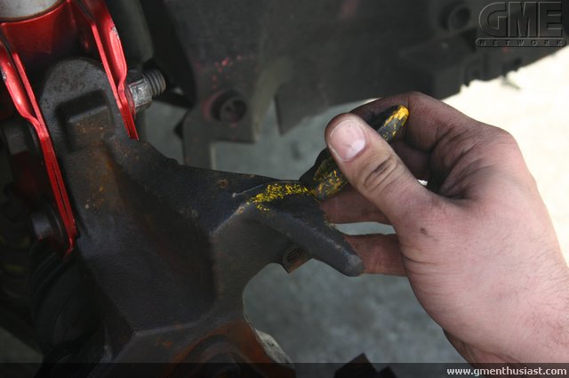

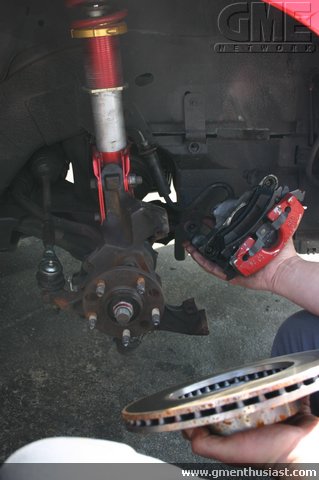

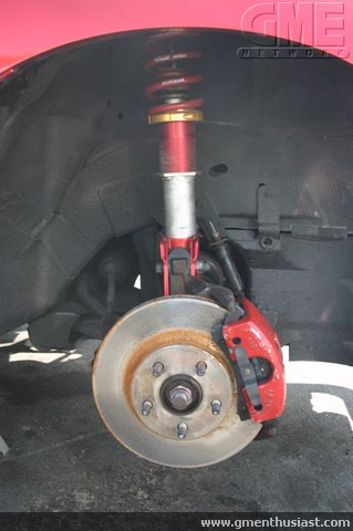

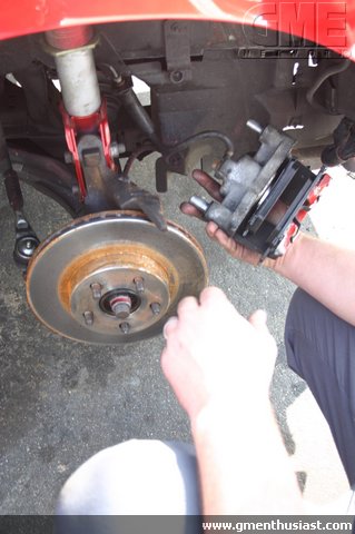

The caliper has what you call a caliper slide/bolt. The first inch of the bolt has threads on it to attach to the steering knuckle, and the remaining is a smooth sleeve which the caliper floats on.
Here's what your facing...
These are the ears Jason is referring to.
Before you remove the caliper, take a flat head screw driver through the top hole of the caliper where you see the rotor vents and out through the front pad facing you. You are only using that for leverage to compress the piston back into the caliper.
