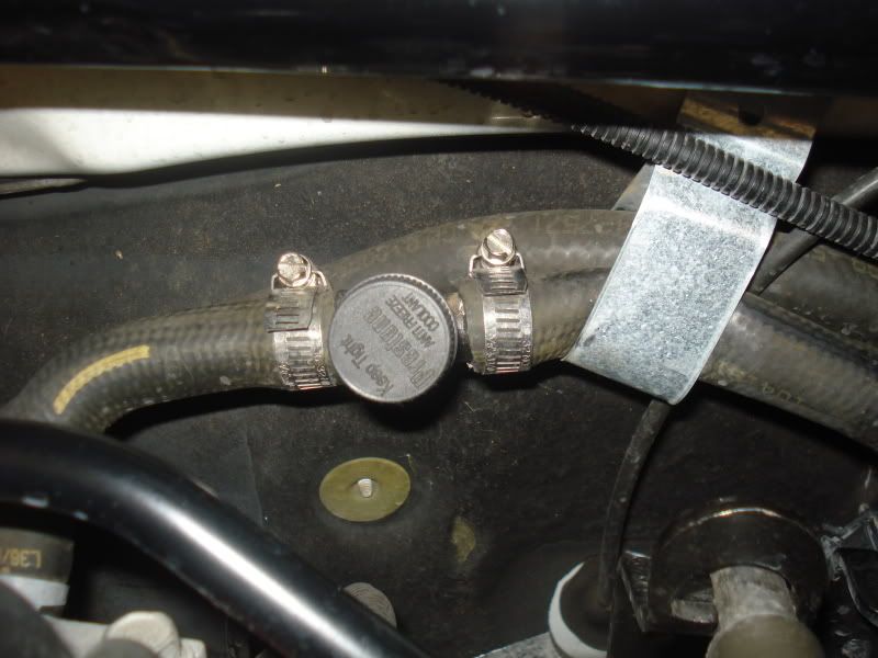

Without seeing the fittings you have I really can't tell what you are getting at. But it is simple. You cut the respective heater hose in a good spot and add the tee connector which is typically around 5/8" for heater hose.
The pic below shows how the special tee with cap from a Prestone brand kit was spliced into one of the heater hoses. It was left in place and has been there for over two years so it will come in handy for future flushes.
