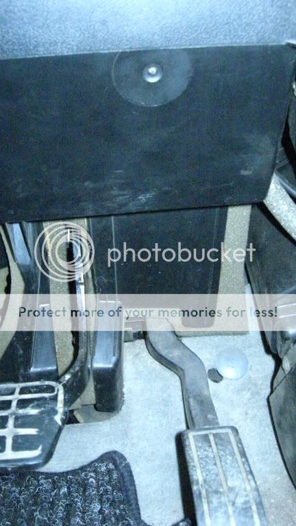

I also took a closer look at both ends of my throttle system:
The engine part seems fine as far as I can tell
the cable enters the interior of the car somewhere in the neighbourhood of the back of the steering wheel
On the pedal end, I'll have to see if I can spend the day during school tomorrow taking off the casing

In the 5th/6th pictures: that plastic cover that is hiding the top of the gas pedal is not on mine. Either someone removed it and didnt put it back, or maybe the Slalom model had it, to keep snow from someon's ski boots from getting jammed in around the gas pedal?

The pedal housing is one piece from the bottom of the steering column down and under, so if yours just covers the front and isn't cut/broken/etc, it must just be a feature of certain years or the slalom or something. I took mine off and sure enough my pedal was not attached to anything engine-related. I didn't see a spring? I couldn't get a very good picture because it's very tight under there, but the red plastic housing where the cable comes in is easy to spot and that has a hook on the end of it that does fit into the rubber grommet at the top of the gas pedal (lower center).
