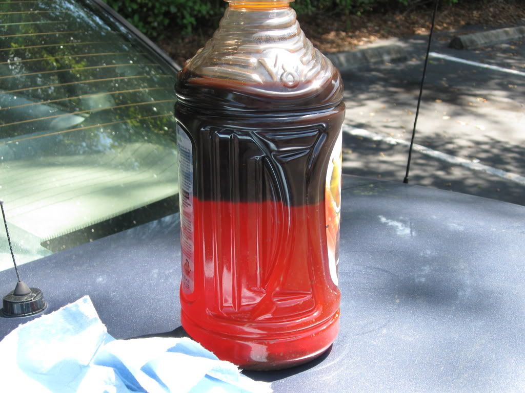

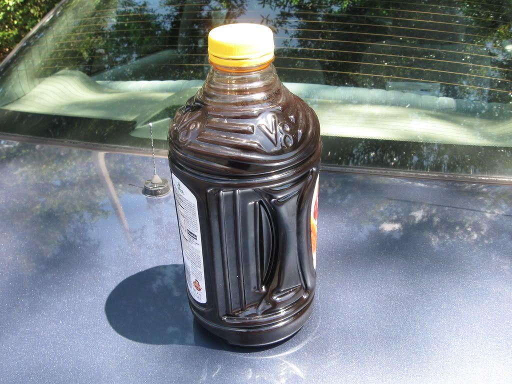

This is the fluid that came out:
I also topped off an empty bottle that had coolant in it (know you shouldnt mix). But it shows the color even better:
Needless to say, the fluid did not smell burnt. I know because I got covered in it . The pan was clean and had no metal shavings, some gray sludge on magnet.
After changing the fluids I can barely notice a shift (compared to what it used to be).
