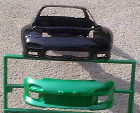

how do you remove a part a body so that i put a different front bumper on?
here is the rx-7 body (black) and the bumper i want to add (green)
i've seen this in a thread before so if anyone knows the link to that thread just post it
thanks!

cmon man, it's obvious
you cut out the bumper from the black one following the panel lines.
use a sharp exacto style knife and becareful not to cut urself or parts of the model u didn't intend to.

wow it's that easy? cool
thanks

Turn the exacto knife blade backwards from the way you usually use it and keep going over the lines until you cut through. When used this way the knife acts like a wood chisel and you should get curls of plastic behind blade as it cuts.

it would be easy if you had a jewlers saw but the back of a X-Acto No.11 will do the job.

Dremel?
