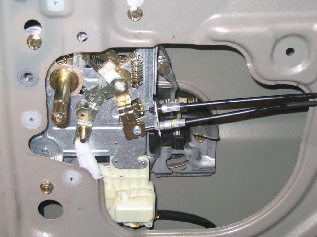

This time I took pictures. This is the passenger sliding door. Not too hard a job compare to front doors.

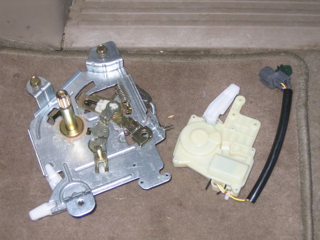

Here what the lock actuator looks like (white part on right). Part on the left is not the actuator. Don't bother dismantling the lock actuator (it actually can be opened up)... dealership sells as one unit - 50$ cdn.
Here's how the lock actuator and lock mechanism fit together:
Here's what it looks like in the door. Only three bolts retain the mechanism. Top 2 bolts don't need to be removed - just loosened - once you've removed the bottom bolt, slide the entire unit up to remove.
