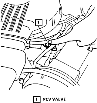

on that hose where it comes out of the intake manifold is the pcv valve. take the hose off and tou will see a nub sticking out of the intake. there are 2 screws holding it and a plate in place. pull the screws out and it will come out. when you put the new one in the side with the o-ring goes down. also make sure the rubber hose is clear on the inside, sometimes they plug up

PCV VALVE TEST
Remove PCV valve from Intake manifold.
Run the engine at idle.
Place your thumb over end of valve to check for vacuum. If there is no vacuum at valve, check for plugged hoses or manifold port, or PCV valve. Replace plugged or deteriorated hoses.
Turn the engine "OFF" and remove PCV valve, shake valve and listen for a rattle of the needle inside. If valve does not rattle, replace valve.
