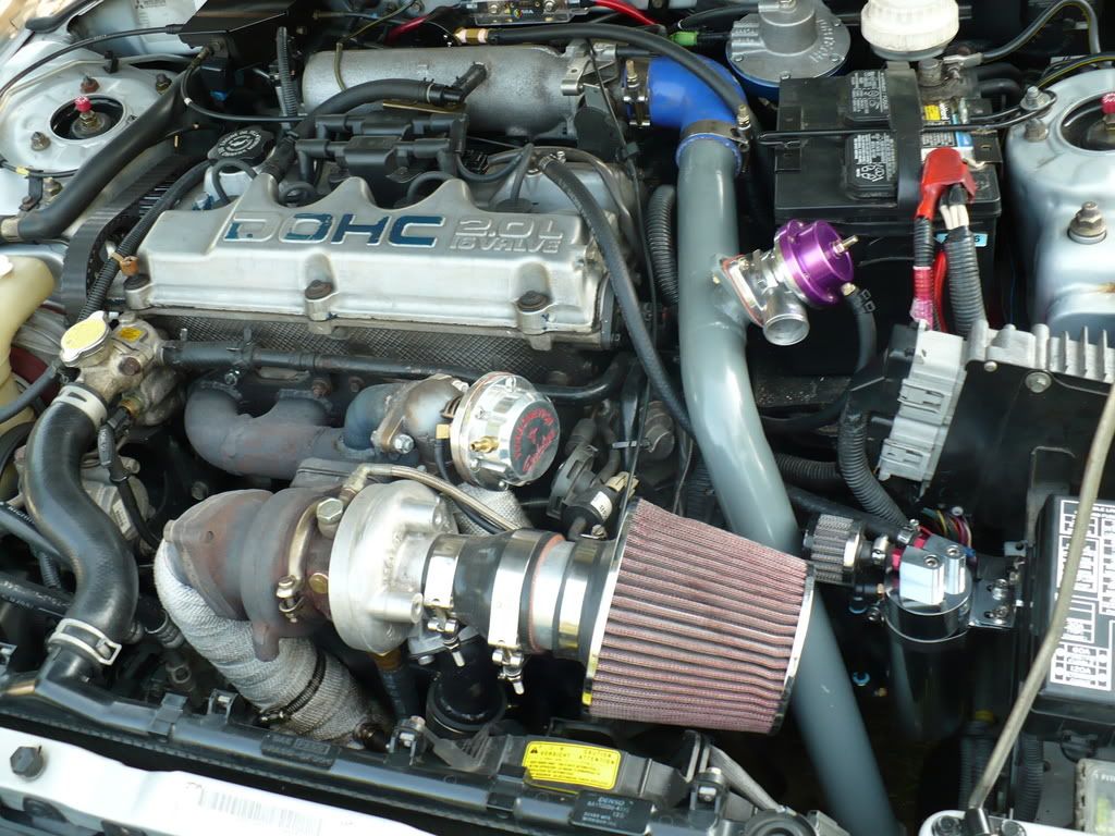

Silvr could you post a pic of your bay with the can on? I wanna see were you mounted it.

It only has to connect back if you run it to the pcv valve. I originally had mine mounted where the washer tank was but my SFMU had to take its place so I moved it right below the fuse box.

Cool looks great. My intake pipe has the nipple on it where the breather from the VC connects to. I could run it back to there, but I'm thinking of just blocking that off anyways. Cool. Thanks guys.
