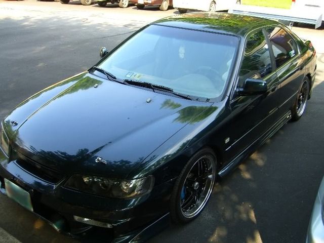

I had Tien Adjustable Coilovers installed on my 95 Accord and a set of front Ingall camber kits in front. Lately it's been squeeking and at first I thought that the friggin Tien shocks were bad. But later I found out that the camber kit bushings were not properly lubed. It was recently lubed a few months back and now the heat has come and the squeeking is back.
Any recommendations on what type of lube/greese I can use for this problem? Only the front driver's side squeeks for some reason. Either it dries out or something. Thanks.
