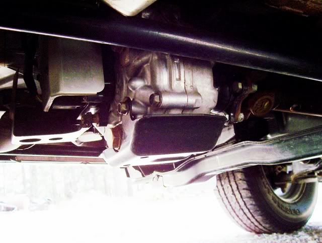

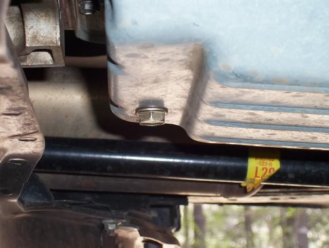

My drain plug is 14mm, and heres a pic to explain why it all wont drain
The transfer case had about a 23mm or so drain and fill plugs.
but nothing like that on the transmission. If anyone can tell me about this transfer case I sure would be appricative. Andie

yep my atf pan is like that too. it did drained but only about 3.6 or 3.75 qts, almost filled a milk jug. but that's it.
I drained and refilled twice to get about 65% of new fluid in there.
I think next time I will do it thru the oil cooler line.
