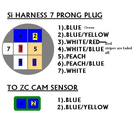

Hmmm..... I'm not seeing those two wires. The bad thing is, the color on the wires are very faded..
Here is what I have:
Old 10-03-2002, 03:09 PM
JoshDM JoshDM is offline
Join Date: Oct 2002
Posts: 18
yeah try to switch the #1 wire with the #2 wire
SiKiller
