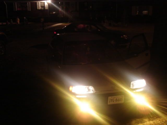

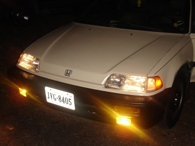

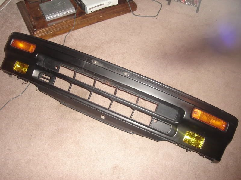

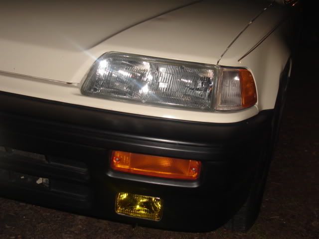

hey just spent a bit of time putting them in my stock bumper, just wanted to share them. i'll take better pics tommorow in the light.

easy to install, just time consuming trying to get the hole just right for the lights on both sides. you will need a dremel with a cutting wheel/ small sanding drum/ and a drill bit. and dont forget pencil and paper to make a template of the first hole to match to the other side lol. and a tape measure (a tailors tape measure would work better because of all the curves in the bumper but i used a regular one)
