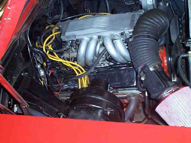

For this installation I opted for this kind of torque instead:

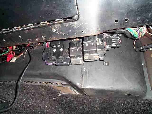

Is that a TPI small block in your 57?
If so, what trans did you use and how did you address the wiring.

Surely it can be done, but there are limitations of how much iron can be removed from the stock head castings to provide upper end flow. Then again, with gearing to keep it away from 5,500+ RPM that wouldn't be a real problem.
As for the '57, it isn't mine, it was just my project. If was rewired complete to accomodate the ECM, fuel pump, all the sensors, etc. The only thing it doesn't have is cat converters and an EVAP canister, but I programmed those out along with the inputs for the auto trans. It has a TH350 but no VSS, no top gear switch, and no TCC. With the programming changes, the ECM doesn't care.

The power wiring, ALDL, and MIL:
And a closer look at the engine:
