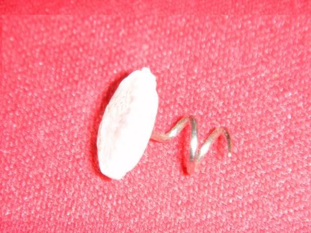

The head line can be tacked up with upholstery tacks,
they sell them at hardwares and of coarse walmarts in thier sewing section.
Heres a pic of one of those tacks.
It also can be glued with contact glue in the spray can.
