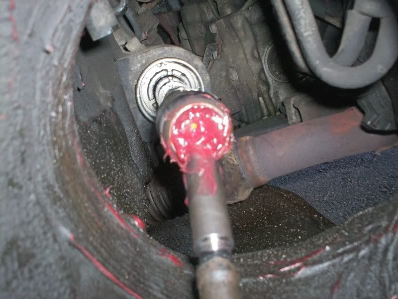

here is the passenger side inner tie rod after I took the old split / cracked boot off and cleaned it with a rag soaked with carb.cleaner. I did spray the inner tie rod joint with carb cleaner a few times to get it squeeky clean. I couldn't resist. I think that was my ocd acting up. I did check the inner tie rods for excessive play and there was none. still in great shape after all the miles put on the car.

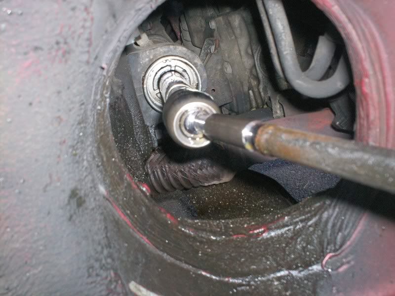

once the inner tie rod joint was clean and dry I loaded it up with grease. I pressed the grease into the joint the best I could while moving the tie rod up, down, left, right (you get the picture). even turned the tie rod a few times clockwise / counter clockwise while working the grease to into the joint.

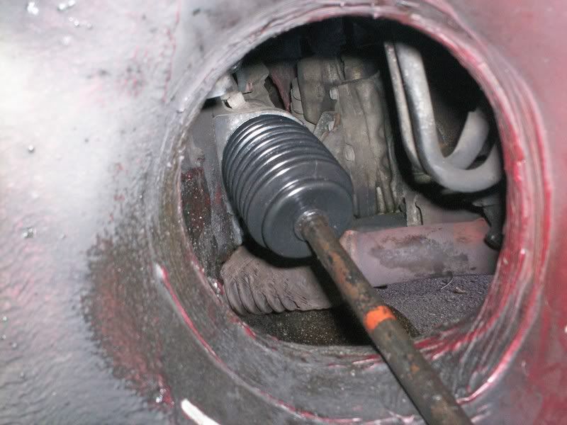

once I was done greasing the inner tie rod joint the best I could I slipped the new boots on the tie rods. I needed to take the outer tie rods off to slip the boots on. I greased up the tie rods and the threads like Davemac2 said to make installation eaiser and to prevent the new boots from ripping.
Last time i'll have to replace these on this car considering the boots I replaced were the original inner tie rod boots. around 17 years old.
