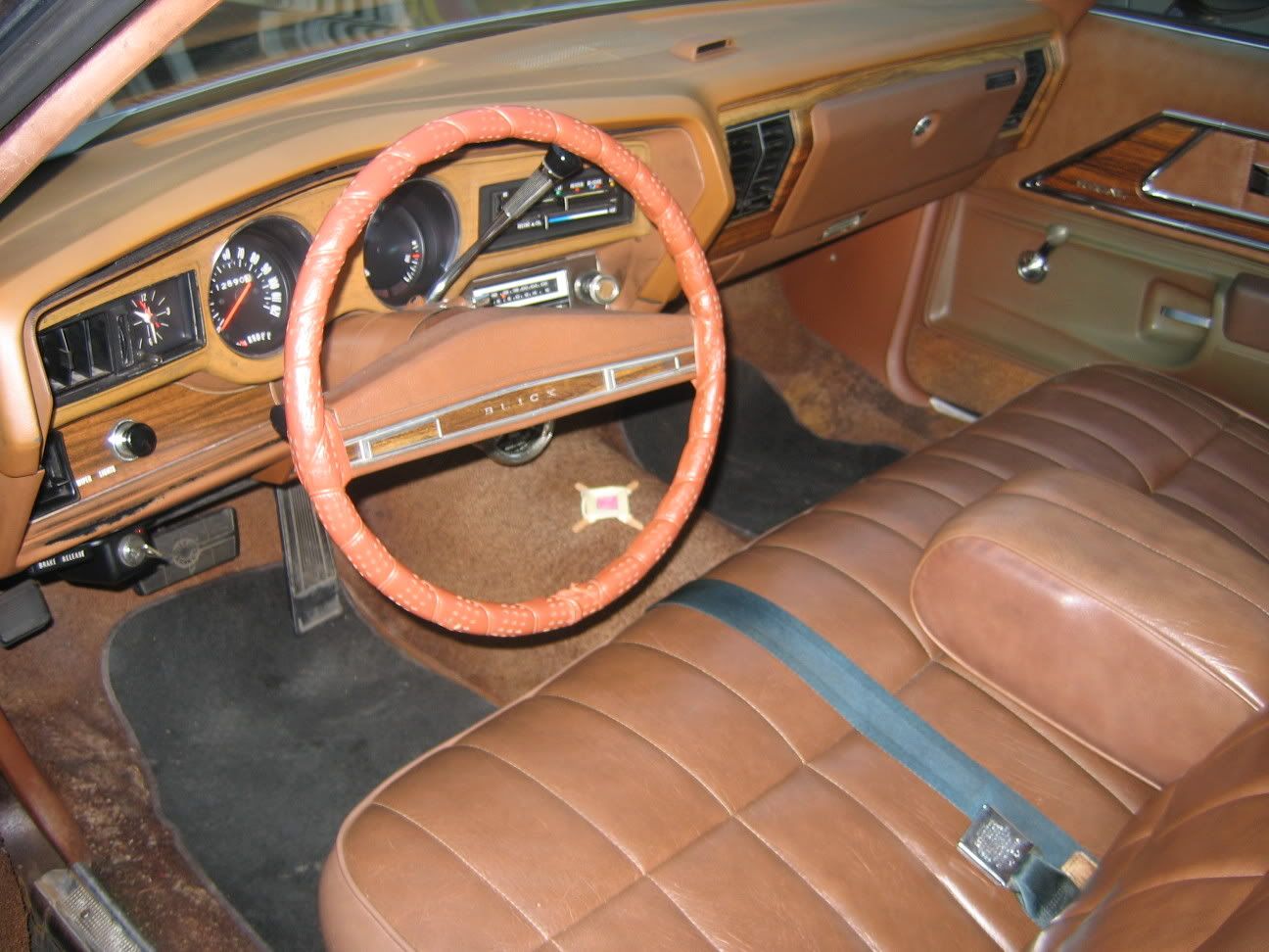

I've been trying to get a tan colored dash. It's the piece that holds the gauges and radio, etc. Someone cut the radio out of mine and left me with a big hole.
Here's my current dash. You can see I fabbed a piece of brown plastic to hold my radio in.
http://i69.photobucket.com/albums/i7...l/IMG_2052.jpg
