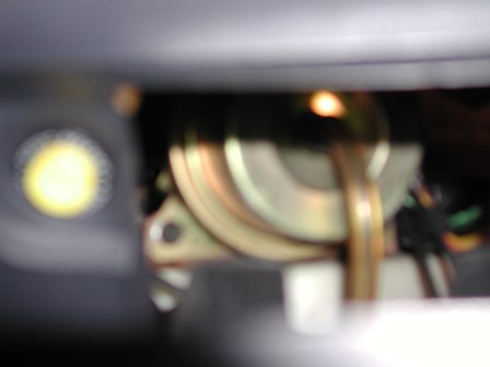

the coolant temp sensor that is inline on the heater hose (should have 2 vac lines and 2 wires on it) when it doesn't detect warm coolant it will turn off the fan for the floor/heat setting.
If you are getting air flow on other settings but it doesn't get hot, you may have a blend door problem. There are a few fixes for this, some can be found at www.lincolnsonline.com I just pulled the vac line off of it and it closed. This works if you don't mind the heat being full hot all the time. The vac line is behind the glove box you should be able to see it without removing the box.
<-- this vac line

Removing the vacuum line MAY do it, HOWEVER, the vacuum motor that the line goes into, comes off with 2-8MM screws, and on my 86 TC Cartier, the bar that goes over the Blend Door shaft had slipped off and I had to get it back on the servo, it was not to hard, and VOILA !!!! It worked, and while I had mine off, I put a small bend in the servo shaft to prevent the blend door shaft from being able to get off again!
Good Luck
