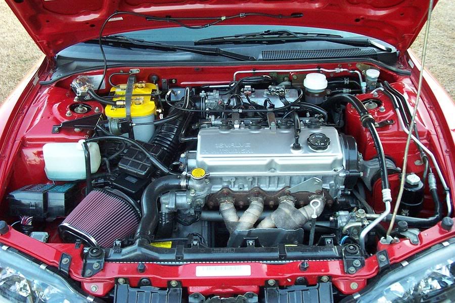

Yeah it will work. I done the same thing with a K&N FIPK made for the gst/gsx. I didn't really move the fuse box, I just took it off the mounting bracket. You only really need to actually relocate the fuse box if you are turboing the car. But I doubt you are. So this is what I did: I just took off the old airbox and, bolted the adapter to the mass and bolted the filter on, then I just fabbed up some brackets to hold the new filter up. Heres a pic if it helps.

wow thats a clean engine bay :twothumbs:

Thank you thank you. I'm actually quite proud of my engine bay. Its dirty now, I need to clean it.
