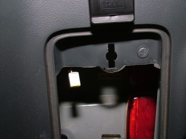

FYI:
it's tucked up there....

Nice pics, Directory! These are worth a thousand words. On my '97 it's in the same location.

Peekaboo! There she is! Nice work Directory. What's the magic reflector for?

it's a magnetic service light that sticks to the back of the tail gate. it flashes red when i'm stopped on the road.
