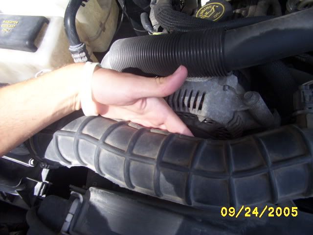

the problem with moving my MAF is that i have no where to put it. I presume if i made my own intake from CPVC i could move it down towards the throttle body (perhaps even directly to the throttle body).
the filter in it now is pretty dirty, so i know just replacing it would add to fule economy, but if im going to spend the money for a filter i may as well add a few bucks in there and see if i can gain somehting else. If i where going to do this i would bend up some sheet metal and seal it to the hood for a heat sheild so it would pull form behind the head light and the fender well.
ill see if i can get some pictures of the engine comparmetn up soon.

i cant go with much bigger tubing (3" maybe) because of the alternator and fan shroud
maybe i can glass some bungs onto the PVC for these sensors, w/e they are.
