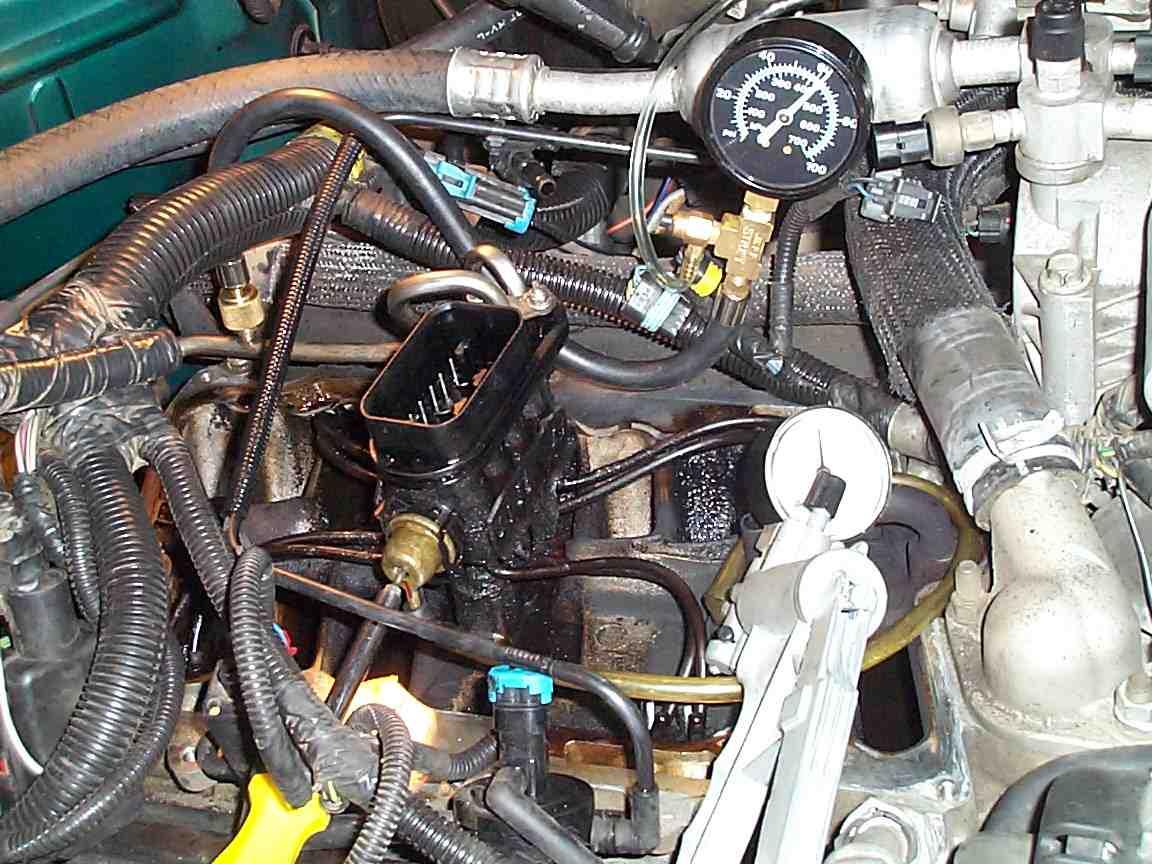

Did you set the FPR when you installed it? Most come out of the box a few PSI off the optimal setting. Once the intake is opened, adjustment is pretty easy:

nope...i just took the default fpr..hope it won't be a problem, the truck seems to run ok with the new pump in...the pump sounds different then the old bosh, sounds stronger and more consistant. thank you for the pic too, wish i had that yesterday would have saved me a lot of time finding the fpr.
