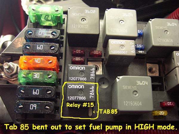

Im not sure what the resistance is,but if you feel that may be a problem, try doing this and see if the car start's.Ive had that done to my car for over a year.It will just By-pass the resistor with no ill efect's.
