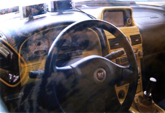

Eeer... It's not that easy because f.e the monitor of the computer is normally more to the right , to make it better visable from drivers seat...
Anyway , anything can be done:
