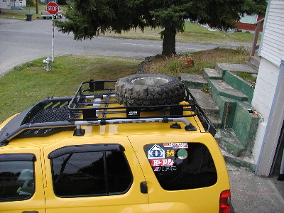

I spent some time looking at roofracks on the internet and I quickly learned that roofracks are damn expensive. My solution was to build my own. Building my own rack allowed me incorporate the features I wanted and it allowed my friend Rich to practice his welding skills.
The rack is approx 60"x40-something". A hi-lift mount is located on the drivers side and the center of the rack drops a couple inches between the stock bars so the spare tire is as low as possilbe.
The pictures are from last weekend when we built it, I still need to finish the paint job, add light tabs, and mount it to the X. I'll post more pictures when the rack is completed and mounted.

COOL! I have been thinking about modifying my Surco rack so it sits down between the factory rack so I can get my X in the Garage!

You and Rich did a GREAT job on that safari rack. Kudos!
BTW - nice STOCK spare tire!

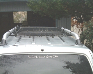

These pictures show how I dropped a Nissan safari rack between the rails. Just a quick and dirty using U bolts and book shelf HD supports running underneath the rails to support the rack. I used hose clamps (covered with black tape) to fasten the rack to the supports.

Nice workman-ship! It does not look home made at all.
