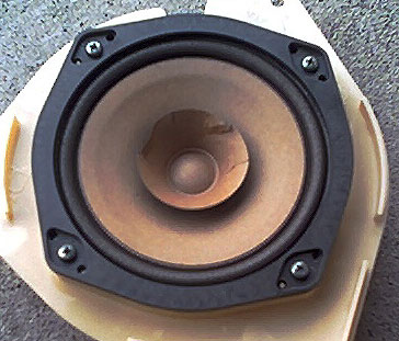

Talking So that's why my bass was stuffed...
I know I shouldn't have expected too much bass out of the factory speakers, but still... When I got the car it sounded fairly good, then the bass left, to be replaced by a btbtbtthththt sort of noise
Bought some new speakers at Autosalon cos it seemed like a good idea at the time, then everyone tells me you can't just throw 6x9s in the back of Skylines, so they sit in the box in my garage for many many months.
Well I finally decided bugger it, I'm gonna have a go
Here's why the bass was buggered:
And yes, My Pioneer 6x9s do indeed fit in the back of my Skyline:
I is much happier now
The best thing about the new AF? I can post again

Don't you love expensive cars with cheap paper cone speakers!
I did all 10 speakers on a 928 porsche the other day that were in far worse condition. The foam seal between the cone and the frame had come away completly on 8 of the 10, and all 10 speakers are in a custom shaped surround to fit the 928 interior.
Forunatly theres a shop in West Auckland (I cant remember whats it's called) that reattachs the cones to the frames. But for a car that cost $200,000 you would expect it to have better speakers.
The door speakers on my Civic, and the Prelude were both exactly the same, infact I have no seen a paper cone speaker last more than about 8-10 years in a car, but I know of home speakers that are over 20 years old are only now starting to break down.
Your old ones are not really that bad, at least the main cone is still attached.
So how much did you have to cut out of the back of the car to make the 6X9s fit?
(nice choice of speaker by the way)

My speakers developed a nasty rattling noise. when i pulled them out i tured them upside down and half the cone fell out!
Got some decent componants now so it much better

They're not so much "bolt-in" as "stuff them in the back and squash them on when I put the parcel tray back in" You need to take out the rear seats, and get the parcel tray out - the speakers are attached to it, so you need to unscrew them. I used the template that you cut out of the box the Pioneers came in, and cut new holes out of the parcel tray. There are gaps left, but I just arranged it to make sure the screw holes weren't over gaps. Then it was the simple matter of screwing the new speakers onto the parcel tray, and the not-quite-so-simple matter of levering it all back in, and soldering the speaker wires on. I actually had to add an additional bit of wire for the passenger side speaker, as the connector bits are in a totally different place (although I spose if I had checked it out beforehand, I could have simply attached the speakers physically the other way around....
In answer to your question Moppie, I didn't cut anything out. Even if I had cut some metal for them to sit in better, there's no room really before the magnet on the passenger side would be hitting the battery - conveniently placed just below it. What I will be doing at some point is doing a new parcel tray with some actual mounts to hold the speakers, but what I've got will do for now.
And yeah, I like the Pioneers. I bought them simply because of the price for a brand i recognised but I've since had a listen at Proclass in Auckland to a bunch of different front/rear speaker combinations. I'm sold on VDO Dayton 5"splits in the front, but the Pioneer 6x9s sounded better for rear speakers than the VDO Dayton 6x9s, so I'll stick with them.
