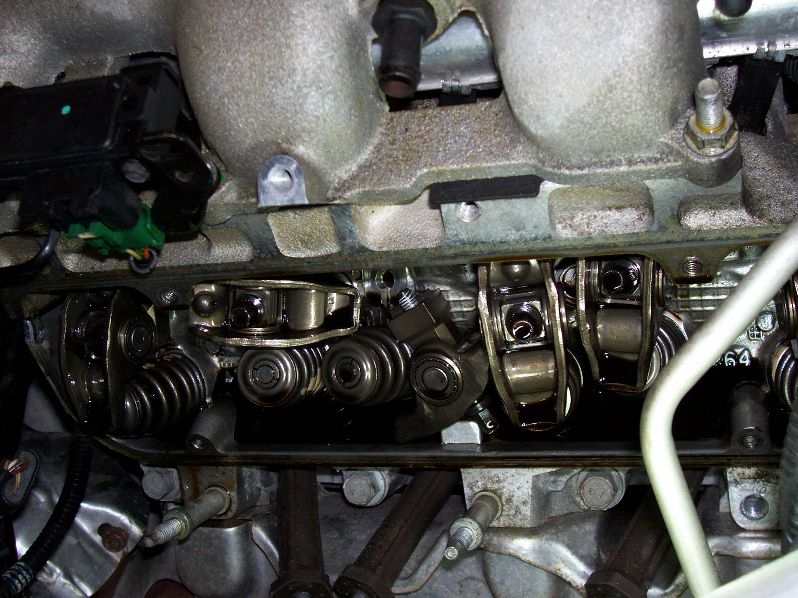

Along with the V-6 stud/rocker problems:

Actually, the one in the photo had no lifter/rocker noise at all, just two dead cylinders.

Agreed on the noise issue, just fixed an engine with pulled threads using a TimeCert kit, got lucky it was the front bank. This engine only had a slight noise, but had a misfire. Top of that valve stem looks bad.
