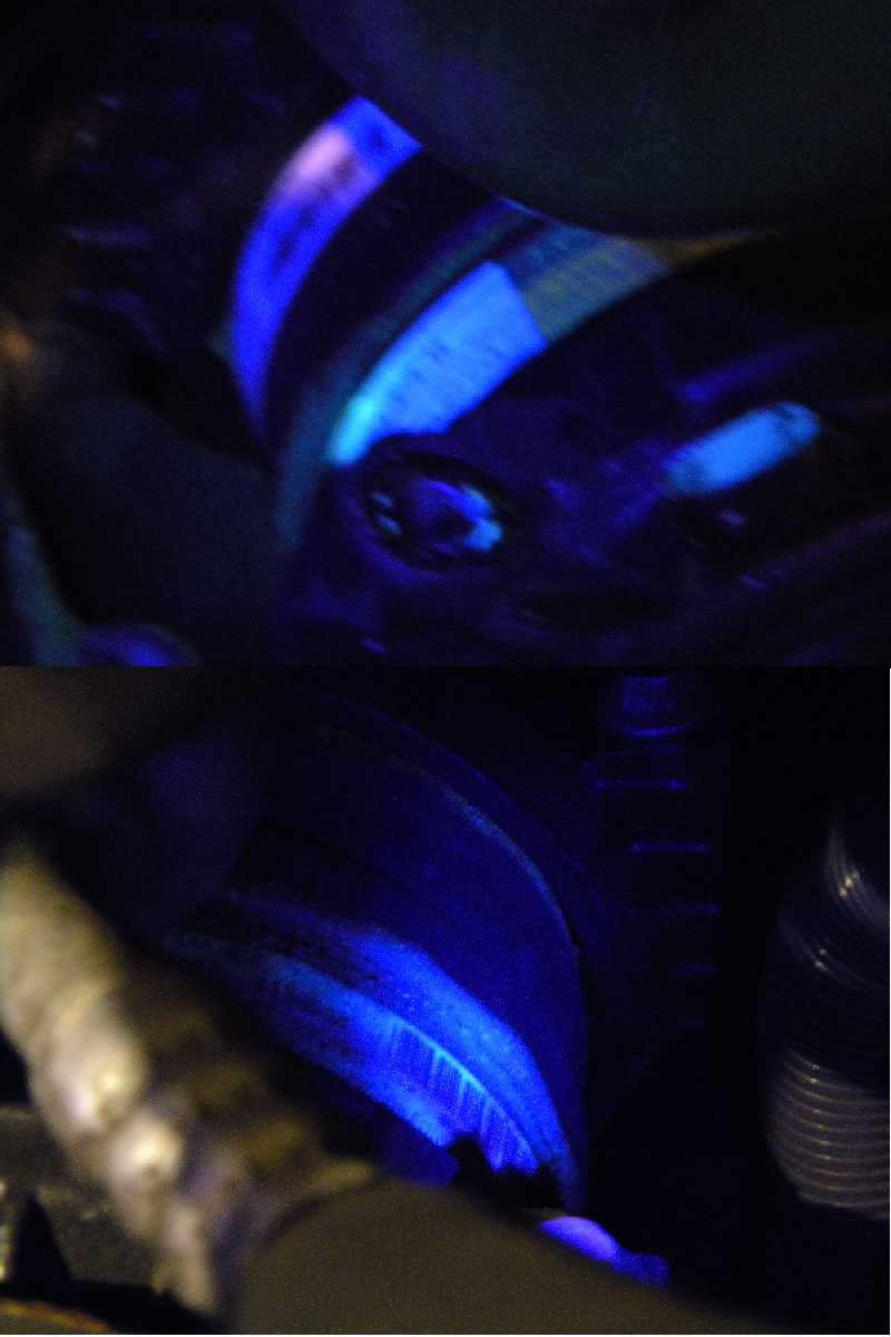

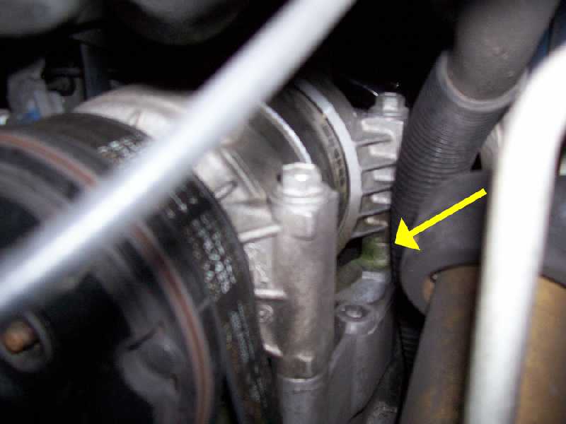

brcidd is on it. That's a notorious area for leakage. I've had several as well. The first photos show the UV dye under a lamp, and green is apparent seeping from the ends past the O-rings.
The second photo is so bad it wasn't even necessary to use a UV lamp to find the dye leaking.
