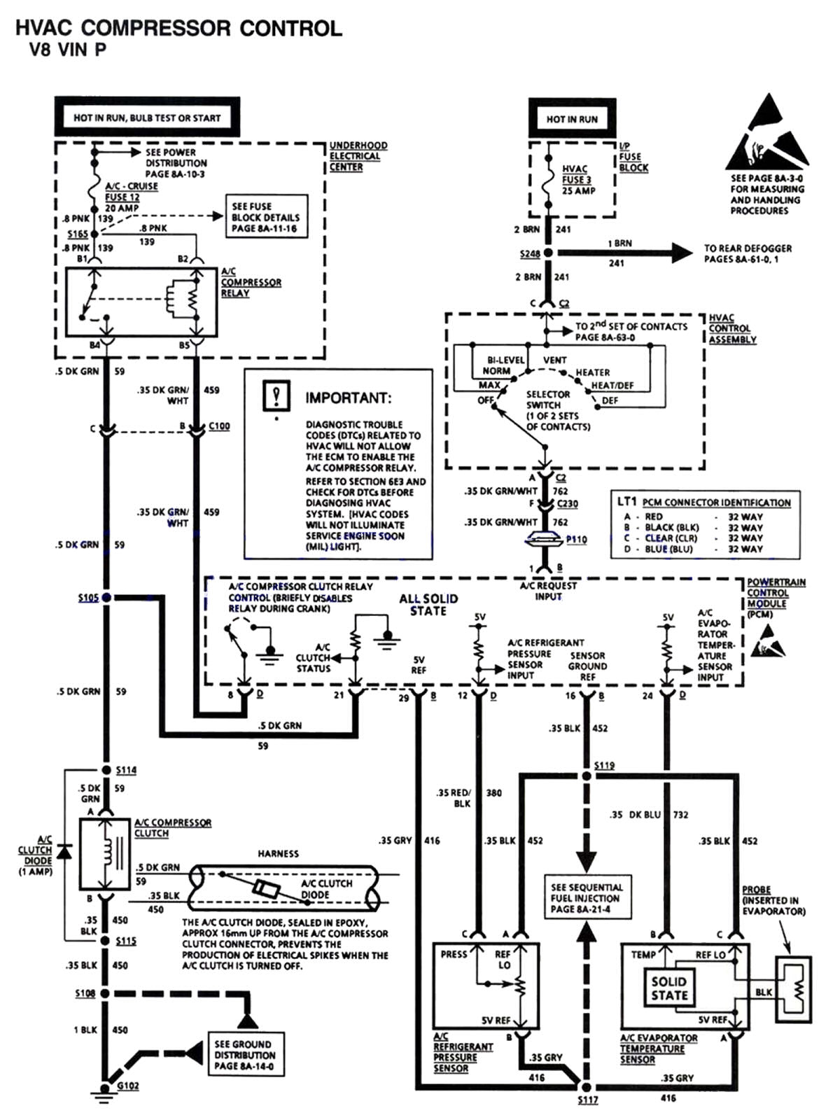

This may help:

[quote=Blue Bowtie;7229051]This may help:
Yes, thank you
