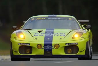

At long last, I am doing my first Ferrari! I have chosen the Krohn Racing F430 GT racecar.
I will do the #83 car of the 2008 24 hours of LeMans:

Are the additional yellow lights parts of the tK or did you scratchbuild them ? they look perfect (but maybe still not adjusted, they seem to be more in the middle of the bumper, isn't it ?)
Hey Phil!
The car has a second set of yellow lights behind the grilles. Here´s how they look with the body in place:
The parts are GREIF lenses, and they are just great! This is where I got them:
http://www.spruebrothers.com/Nextern...4-pcs-205c.htm

Thanks for your answer, Sam, the second pair of yellow lights wasn't visible in your first pic at the start of the thread that's why I asked that.
