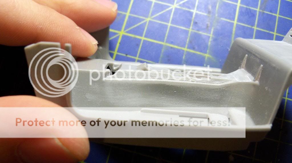

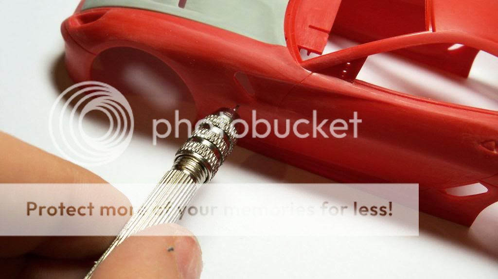

I started with the body. I follow the standard procedure (scribing panel lines, drilling the indicators, sanding the whole body, thinning the air vents, open the door's handle, etc.) and in addition, I separate the side window trim, with the scriber for a more "authentic" look.

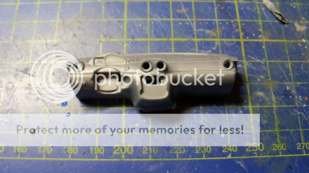

Here the next update with some interior preparations.
Ι open the doors cases and I put the mesh for sound system.
I choose a more sport look for my GTO (I 'll try a retro-sport mix look) so I decide to put the four point seat belts. So I opened four seat bely connectors an I put an oval frame on it (cut from pe set belts).
From plastic rods, I made a roll bar.
In the central console, I scribing the upper part to separate it, from the tunnel.
For next, I opened the air vents to put the HD's pe vents.
In a temporary assembly, I discover that the holes in the top off the dashboard, is not totally covered, so I put some putty on them.
The final step for today is the steering column.
Hope you like my job and thanks for your time.

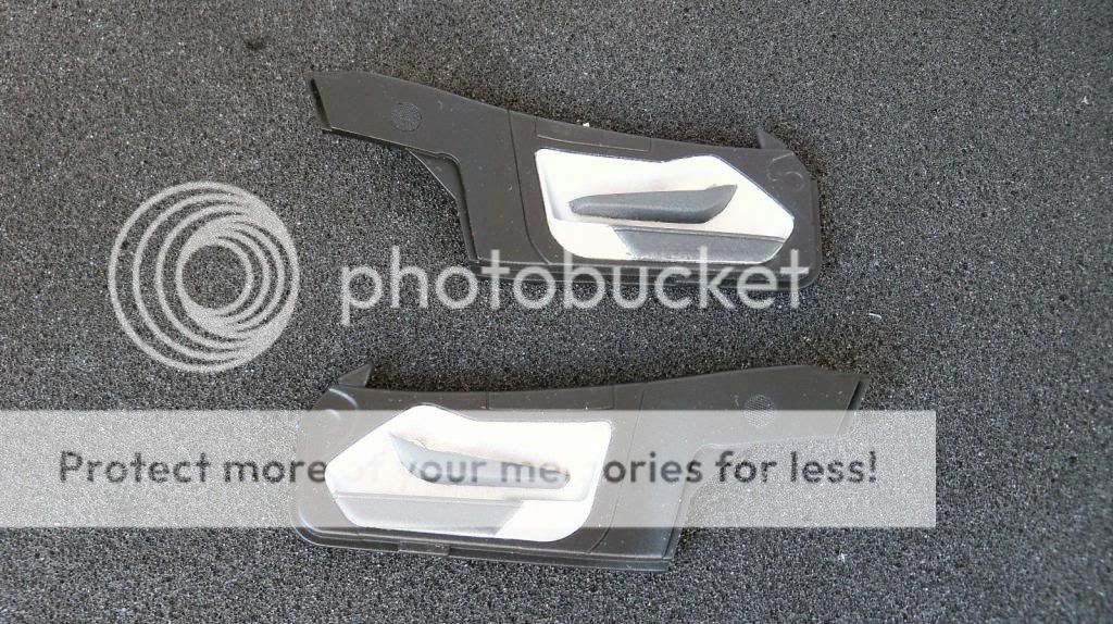

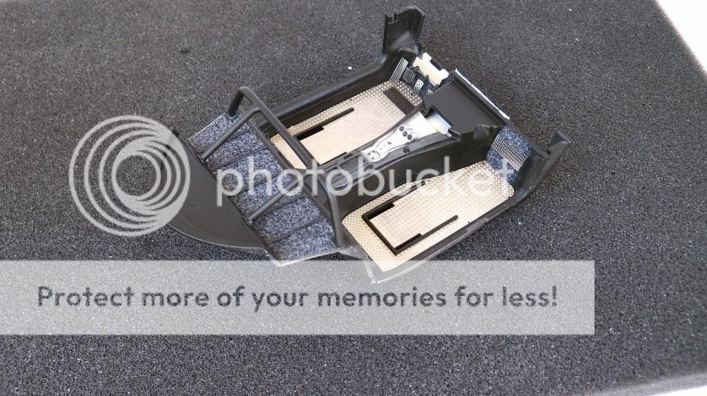

I manage to do some work on my GTO, so I finished the interior.
The inspiration for the interior colors, come from the original '62 GTO. As I wrote before, I try to mix the new with the classic to make a vintage result.
So I choose back leather, white aluminium for panels and some suet details.
For the suet details I put some microballons in my old airbrush to represent them. I didn't choose some texture spreys, because I want a very fine effect.
In the dashboard, I remove all the controls and I represent them from plastics rods. Also, I put some pe rings on the decals for more realistic view. The black, that I used is the valejo black primer a great way to represent leathers.
Then, I make some wash and dry-brushing to interior parts, I add flocking and detailed the interior with pe from Hobby design's set.
The seats is a complicated situation. The central part represent by spraying tire black over a mesh (I use am acrylic matt black as base-coat). Also, I add the necessary cf to the back of them.
And the result...
