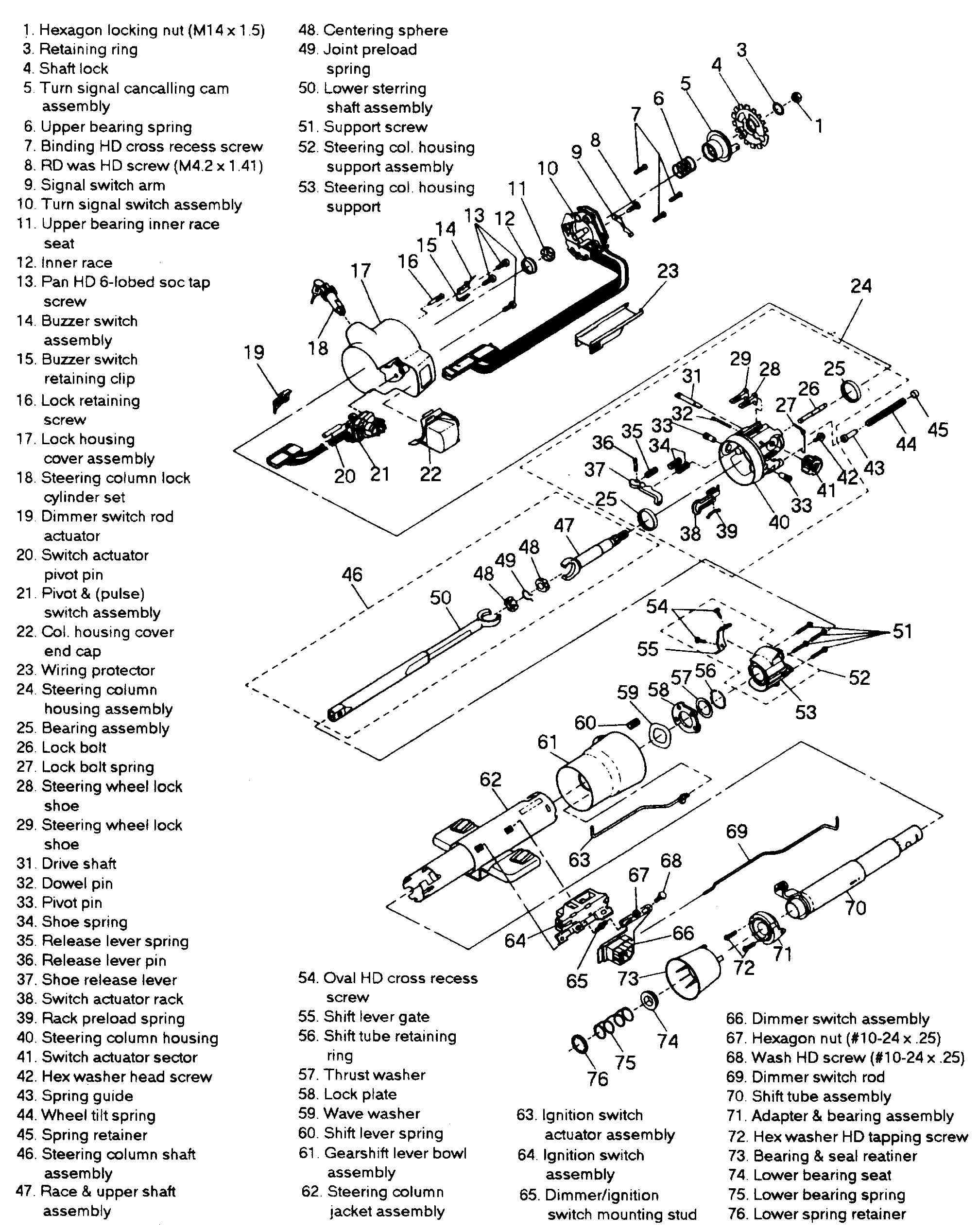

needed to replace the turn signal switch on my 91 caprice. when reassembling i could not seem to get the steering locking mech to engage the way it should. I would like a diagram or photo illustration of the correct position of those parts. if anyone can help with that it would be greatly appricated. thank you.

This help?

Bowtie, Thank you .... THAT WAS EXACTLY WHAT THE DOCTOR ORDERD...The spring had come out of it's correct placement and without that diagram I would never have known the right placment.The spring is bent into a very perculiar configuration and is actualy all one continous lenth of spring steel. Thanks again!
