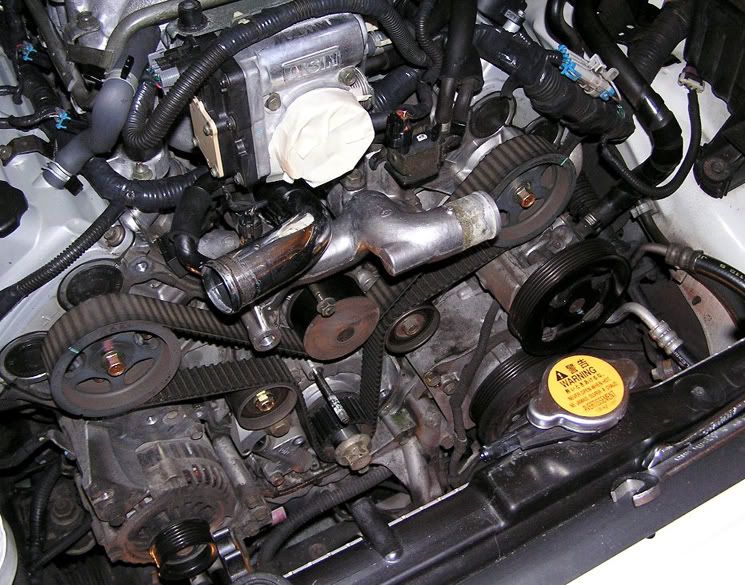

I like posting this pic whenever timing comes up...
