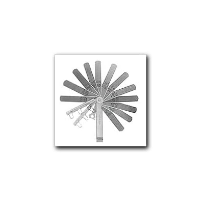

some plugs are pre-gapped, but it just makes common sense to get a feeler-gauge type or wire type spark plug gauge and check them before you put them in
if it's a 4 cylinder engine, it's 3x easier than a transverse v6
as for plug gauges, if you're using platinum tipped or iridiums, the ramp style gauges is bad to use
just because it's not "true"
feeler gauges are better because they're even throughout
wire gauge is also better than that ramp gauge if you want it to be accurate
