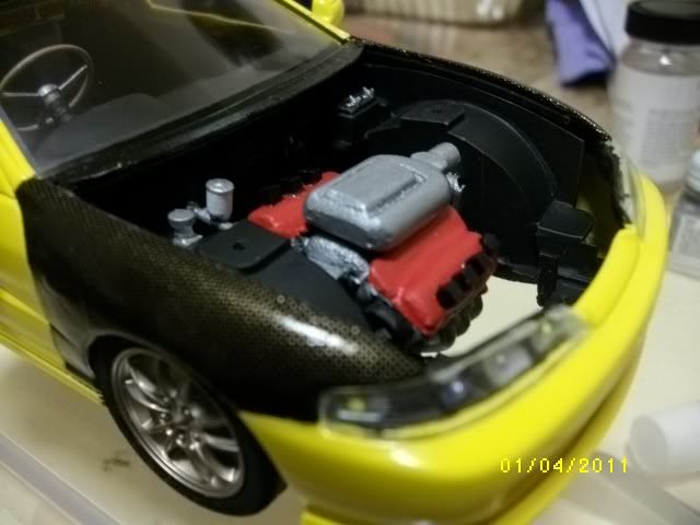

** with the idea in mind to make this mirror, i totally forgot it was going in a rhd car, so mirrors are facing the opposite way....OOPS!
** here is 2 shots of the engine
-got the coil over plug on the valve covers done
-motor mounts in place
-brake and clutch cyclinder detailed
-exhuast manifolds on
>>>> Have very minor work left to be 100% complete with this model...
