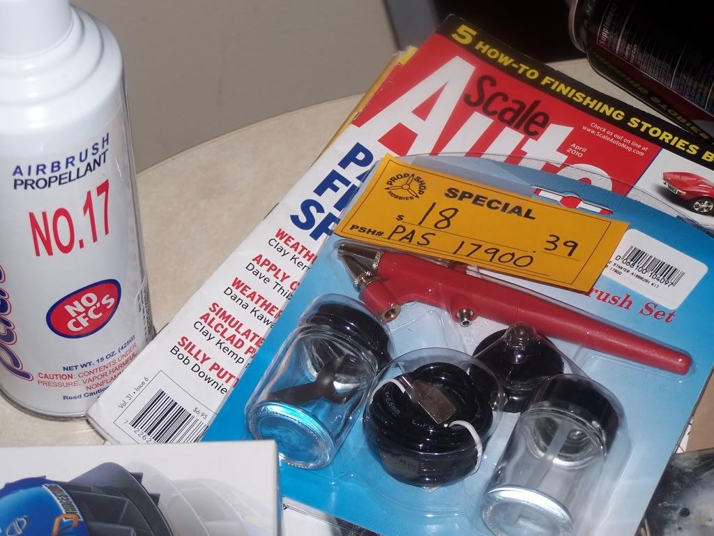

thanks guys(hey chilly) for tips and hints..heres a pic of it

I started that way too, I mustve spend close to $300 on Air propellant cans, wouldve been cheaper to buy a compresser. If your looking at just doing basic airbrushing, think about getting a Tamiya Basic Compressor & airbrush, its pretty handy & easy to use.

I apent around $50 putting this together. If you dont mind the noise its worth a try. At least until you get the hang of things. I still use my badger 350. One day I might try a nicer airbrush.
