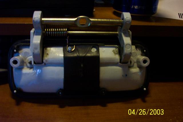

Alright, I finally was able to try your how-to, but i just cant figure it out. I may have bought the wrong handles...hopefully not, but i got pics which will hopefully let you tell me why I'm such a dumbass, or more importatntly exactly wat it is i need to do. Thanx
Now if anyone has any more advise plz feel free, my car goes into to get paint/kit in a few weeks, so i need these on by then, if they're even the right ones.

Those handles look nothing like the ones I got... The spring mechanism is completely different, as is the mounting holes... I think you got the wrong handles...

Yeah I have my sedan handle right in front of me and it doesn't look the same at all on the top parts. Maybe you got Integra Sedan rear door handles?

Ok I just did this swap 5 minutes ago so its fresh in my head. The ones I got off the DX Sedan at the junkyard worked fine. All you gotta do is swap out the metal bar at the top of the handles and bolt them right up and they work fine. Makes your car look nice and clean to.
