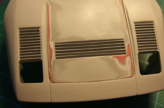

I thought I have to treat the gaps around front bonnet.
I glued 0.3mm plastic papers on both sides, then fulled the normal putty.
You can see the difference of colors on right and left edges. Don't say I've got to treat them earlier. (Of course I should)
Then I applied moving section on bonnet. This picture is the temporary one, I will cut the upper excess parts on bonnet.

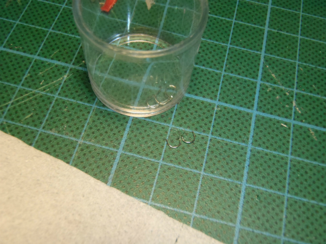

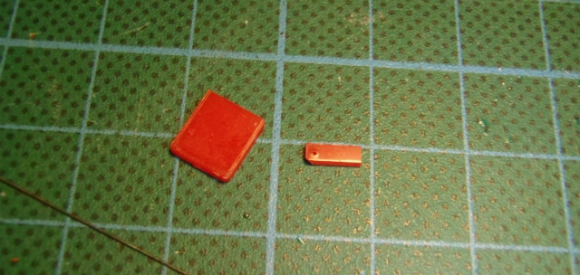

I made 0.5mm hole in a 0.7mm plastic board, then inserted the 0.5mm brass pipe. This part will be glued to the body. From my experience, this part should be as front as you can, so that the moving width would be bigger (so that the body and the bonnet wouldn't hit each other).
This (right small one) is the part on bonnet. The 0.5mm nickel silver rod will be inserted into the pin hole. I am using the number plate part from Fujimi's box, just thinking it is thicker than 0.5mm plastic board.
I made lots of tries and errors on this stays (0.5mm nickel silvers). If they were too narrow, the bonnet and the body hit. If they were to large, the bonnet wasn't fit in the right place...
After some attempt, I found the right place to fit them in. Now I think I could use 0.7mm rods and more thick pipes for more strength, but I don't have guts to redo this job now.
