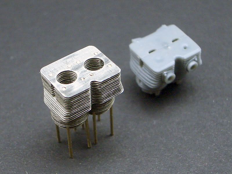

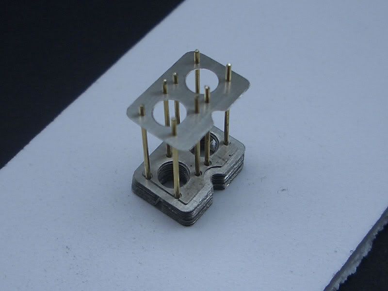

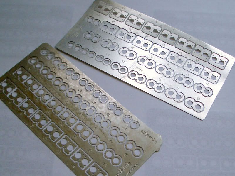

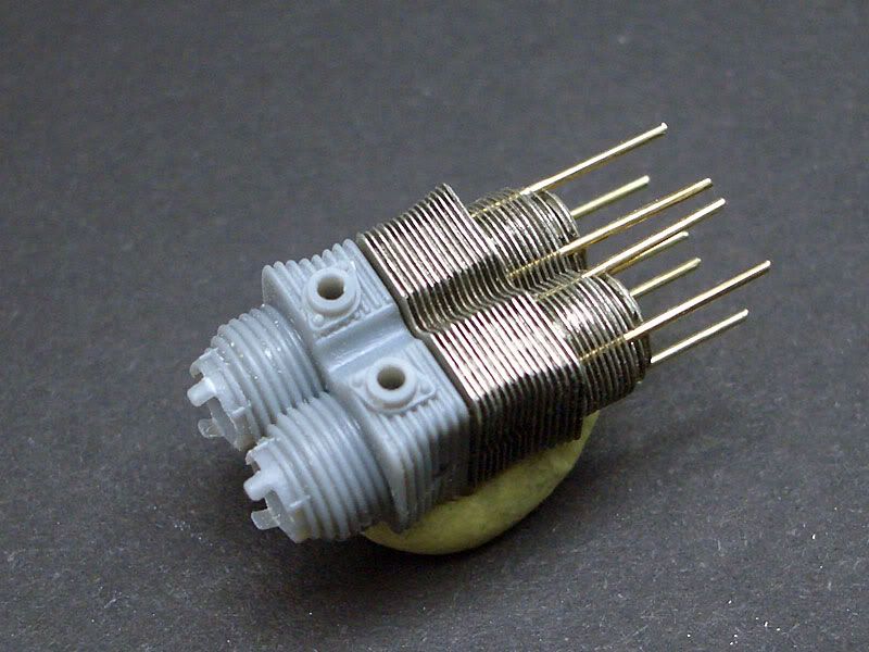

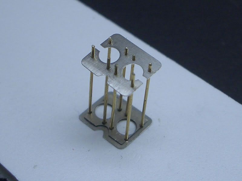

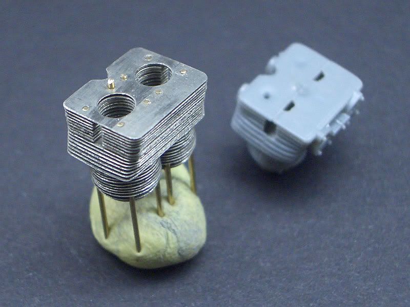

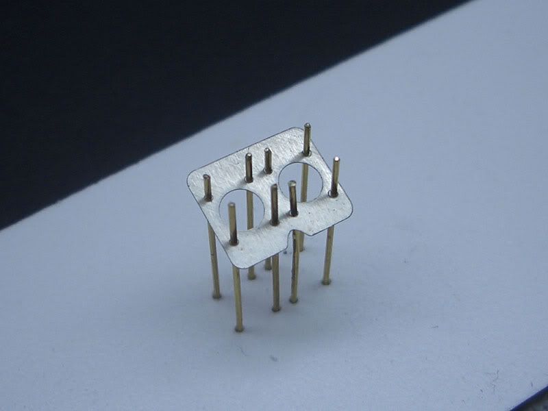

From the start of the job on the marvellous 356 I thought how to improove a stand alone flat4: following the very first prototype of a study to do cooling fins by PE: they're scale thickness thickness (fins thick 0.1mm, spacers 0.2mm) and in the correct number: still some "last detail" to add like aspiration/exaust ports. They're 62 fins and spacers for any side!
